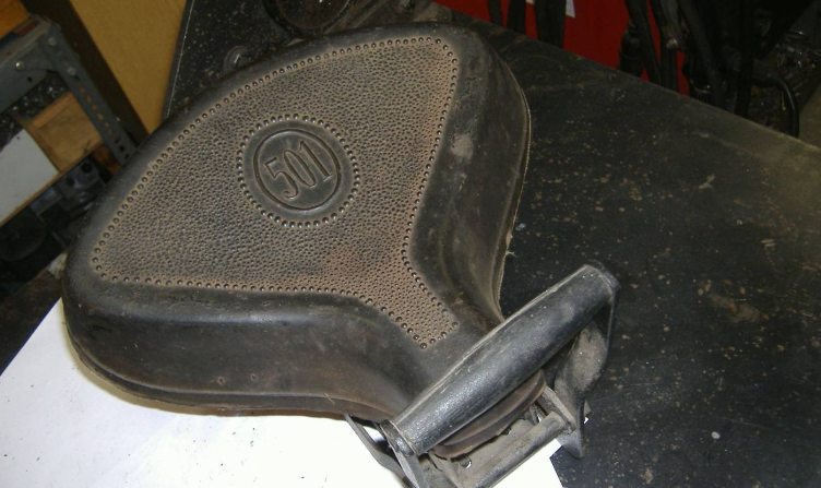

I have two questions:
In English it is called nameplate - there is year of production, engine power and so on. I think that 125/49 did not have that - am I wrong?
Which model had that type of seat with "501" logo?
Thank you for information

- Jól tudom, hogy a 125/49 Csepelknek nem volt adattáblájuk?
- Így van, csak a 250-es Csepeleken volt adattábla.
- Melyik típushoz illik az 501 logós ülés?
- Ezek az ülések pótalkatrészek, akármelyik Csepelre felszerelhették őket.Utoljára szerkesztve a következő által: Titus; 2020 okt. 14, 18:19.
- 3 likes
Titus eredeti hozzászólása Hozzászólás megtekintése- Ezek az ülések pótalkatrészek, akármelyik Csepelre felszerelhették őket..(Félreérthető az"alkatrész"kifejezés.)

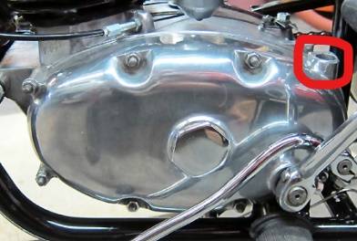

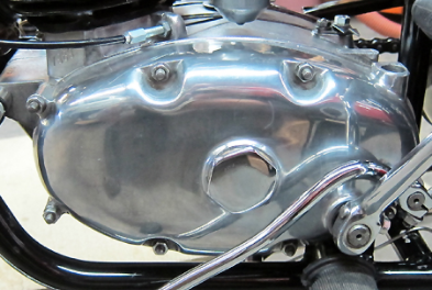

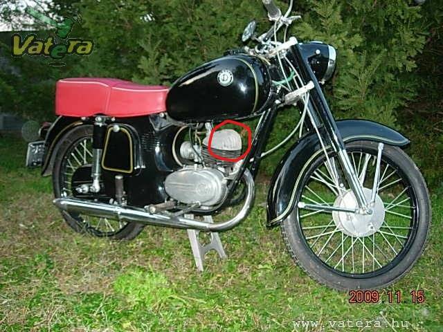

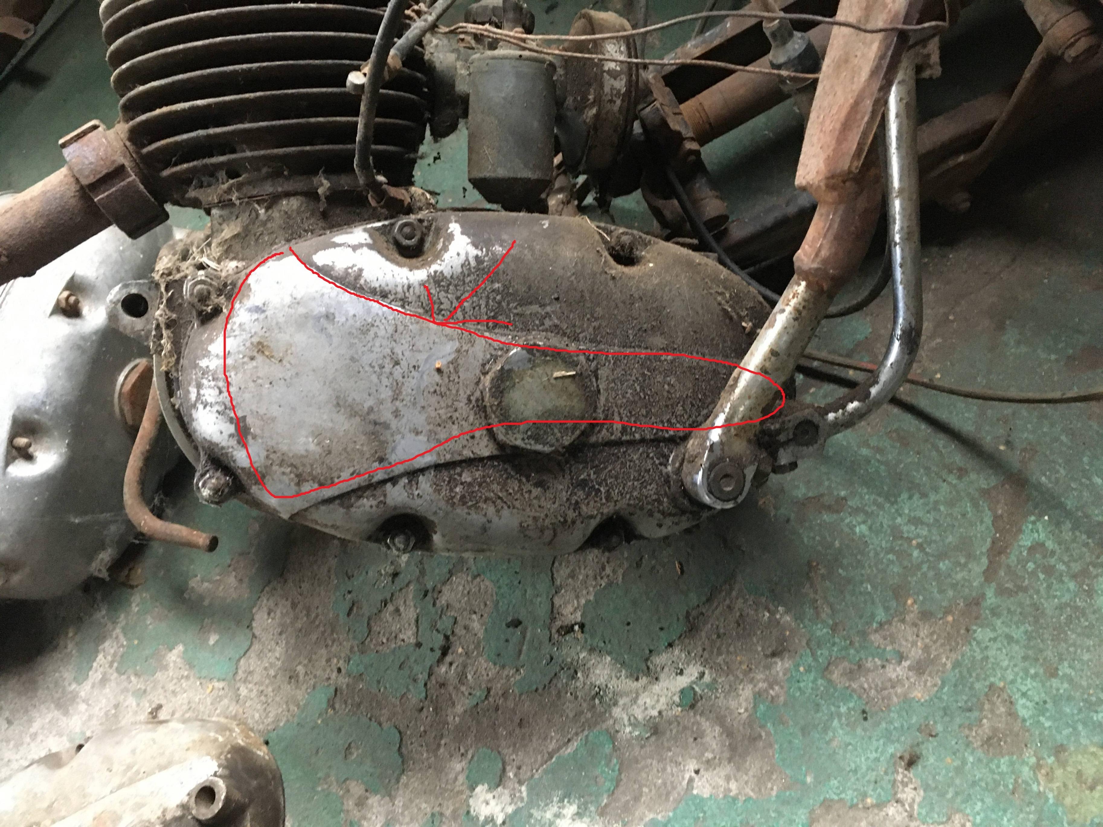

Hello friends.
I have some question about details of Csepel engines, because I have 4 and I am starting to repair minimum one of them.
I need advice to recognize cylinder and head of cylinder. It can be from Csepel 125D, T, Csepel 125/49 or Danuvia 125. Are there any key differences in cylinder or head of cylinder from Danuvia, Csepel D and older types?
Secondly, after searching information I found that this on photo numer 1 can be most probably from Danuvia 125 or Csepel D - on Danuvia photos on the Internet I see that this type is more often but on second photo I found one Csepel with that type of engine. On photo number 3 you can see type of engine from 125/49 and I am sure.
I don't want only get information from you, but I can help if you want. I read one topic about engine numbers and that list was made by Ricsi95D. If you want I can get all numbers from that 4 engines for you and number of frame of my motorbike. but you have to tell which numbers (maybe all).
Thanks for info.
Regards.

Hi Wild,
Wild eredeti hozzászólása Hozzászólás megtekintéseI need advice to recognize cylinder and head of cylinder.
Clutch covers, that don't have oil filler are Danuvia parts. The other covers are Csepel parts like this:
So you can be easily identified them
Wild eredeti hozzászólása Hozzászólás megtekintéseIf you want I can get all numbers from that 4 engines for you
We help you with pleasure!
magyarul:
- Szervusz Wild!
- Tanácsra lenne szükségem henger és hengerfej ügyben.
- A második képen D-Csepel hengerfej látszik, a T és /49 Csepeleké teljesen szimmetrikus. A Danuviáén pedig a bordák elől magasabbak is.
A kuplung fedelek közül, amelyeken nincs olajbetöltő Danuviára valóak a többi Csepel alkatrész. Így már könnyen be tudod őket azonosítani.
- Ha szeretnétek leírom a motorszámaimat.
- Az lenne a legjobb, így könnyen beazonosítható a blokkok eredete.
Szívesen segítünk!Utoljára szerkesztve a következő által: Titus; 2020 dec. 13, 20:24.
