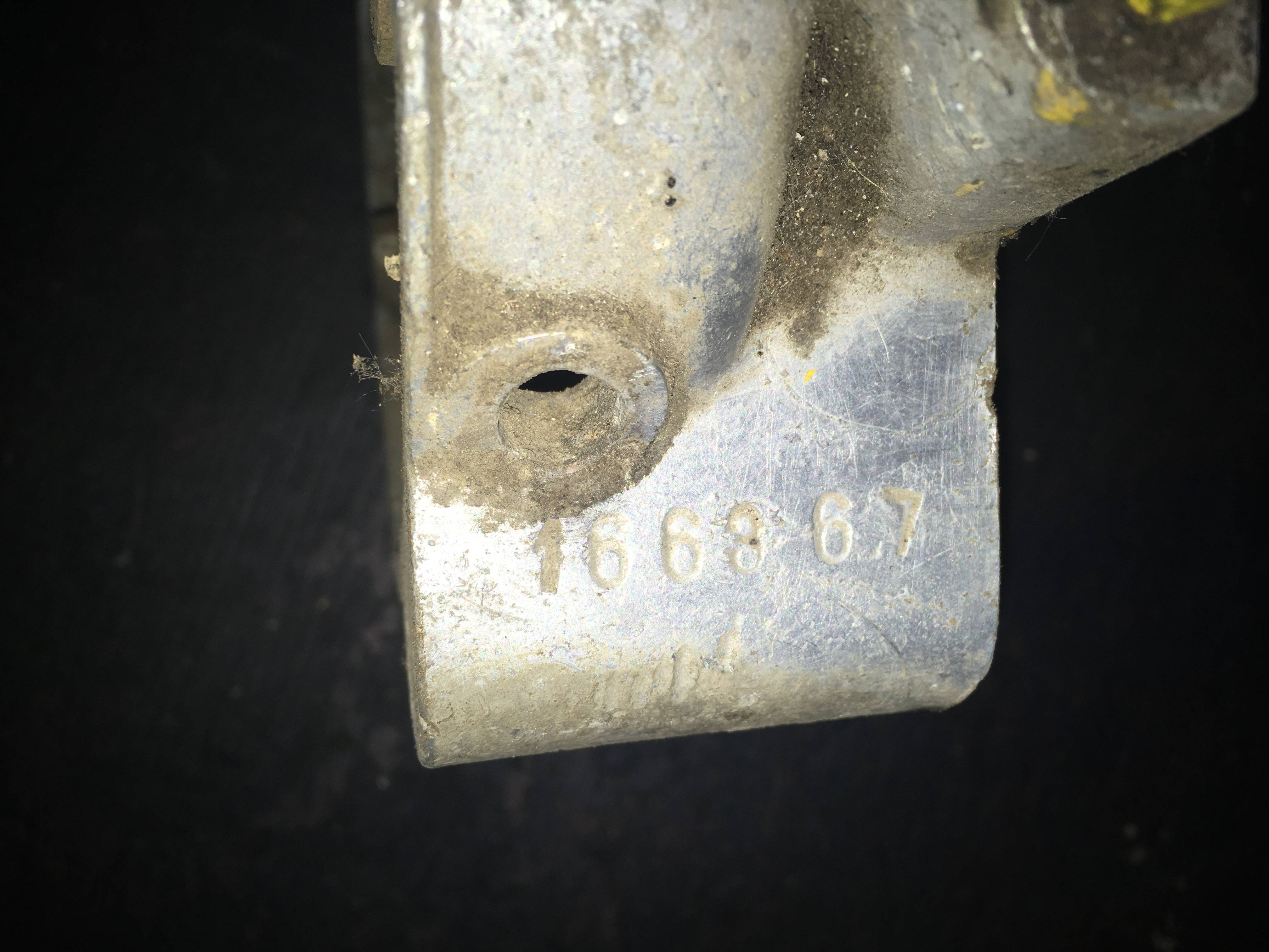

    First post - engine number 1:

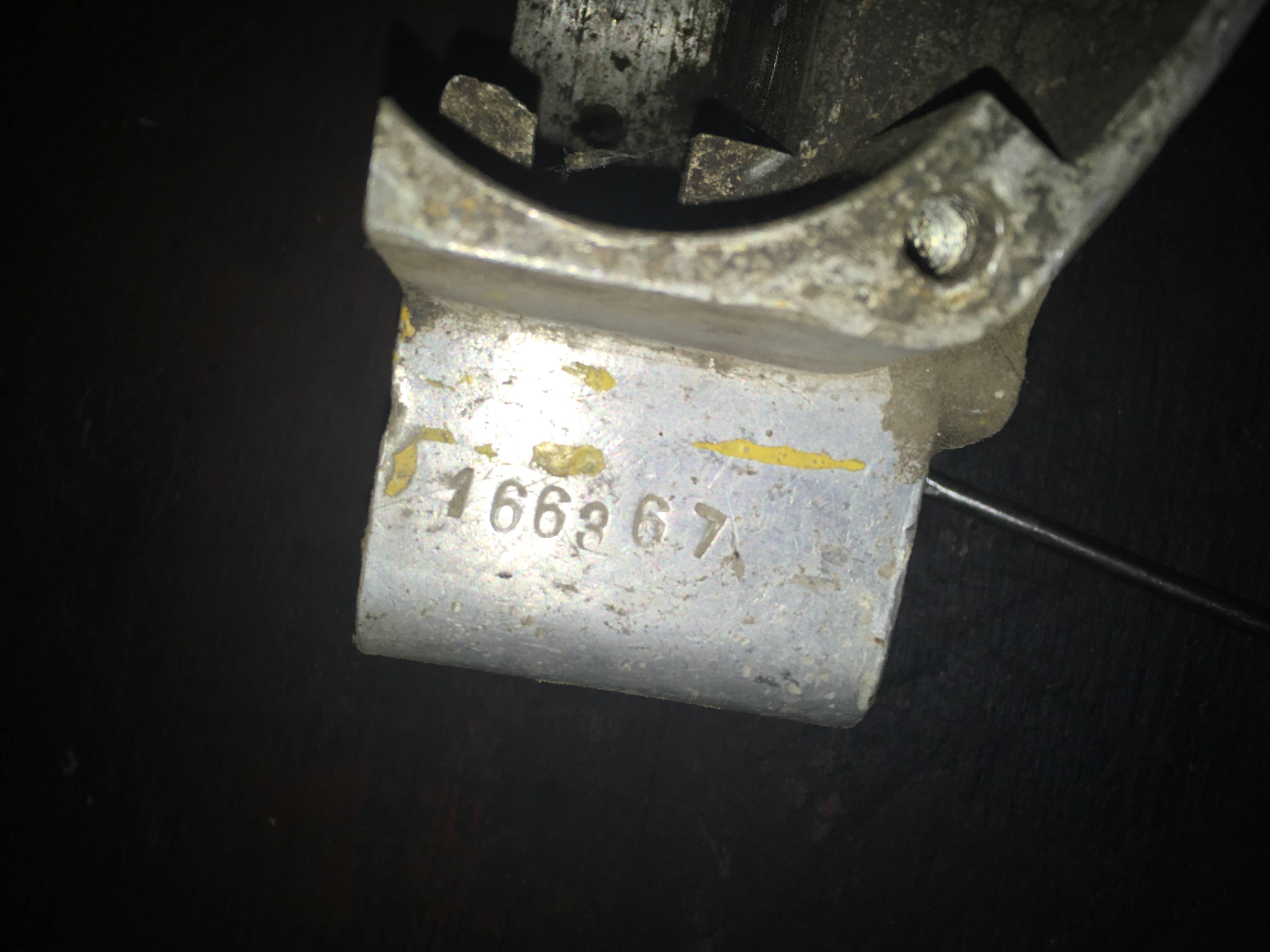

    NUMBERS/számok:
    1 half: 166367
    2 half: 166367 - '3' look like '8' but I am SURE that they are the same
    First photo shows triangle with '3' in it - on other engines I did not notice that - curiosity.
    Second and third photo shows x2 halves of engine with the same numbers.
    Last photo shows engine cover - I guess that it is from 125/49 - engine without cylinder and head of cylinder.
    One thing which is strange - numbers are big, but 125/49 shouldn't have big numbers?

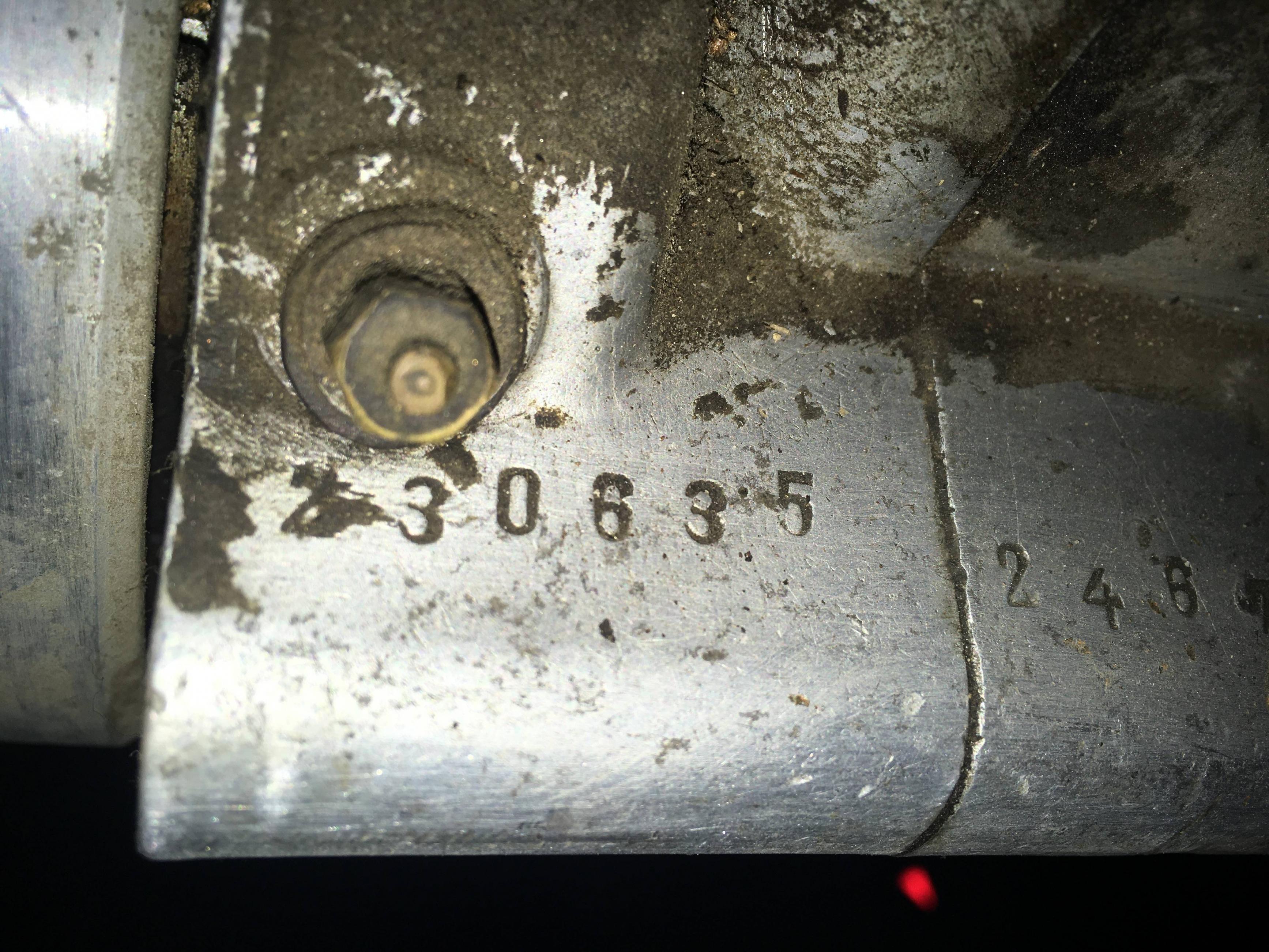

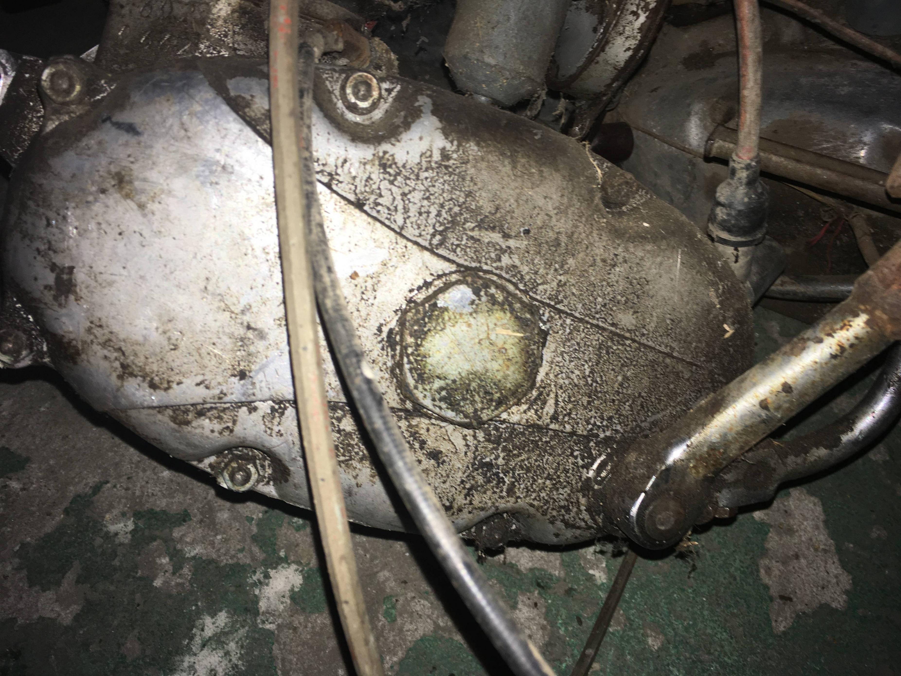

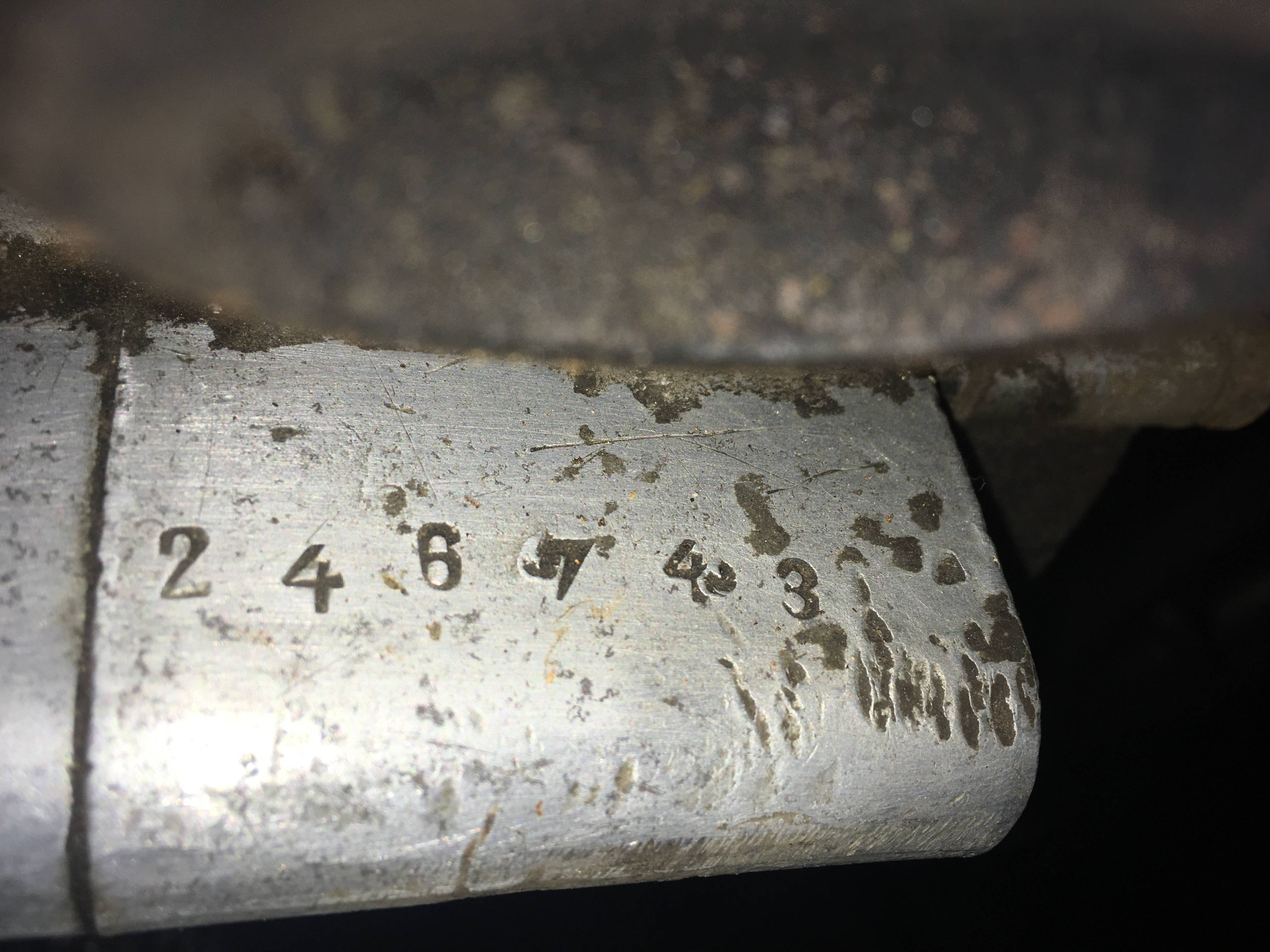

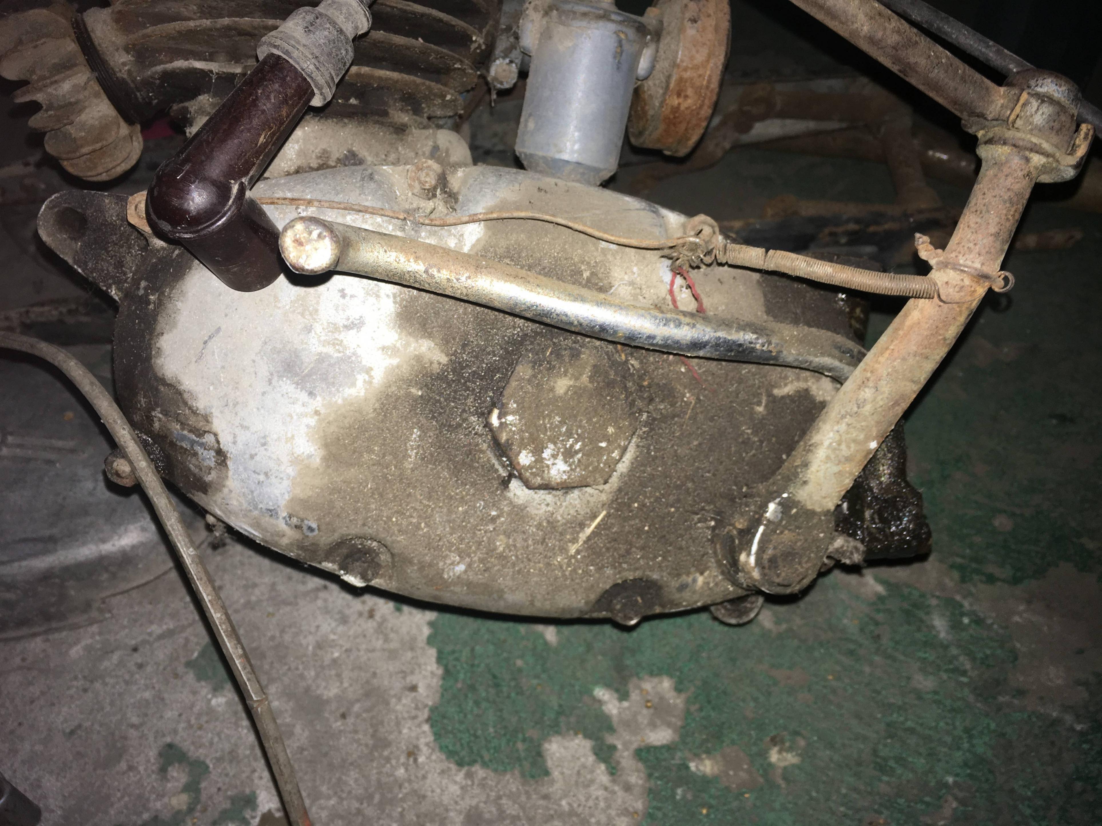

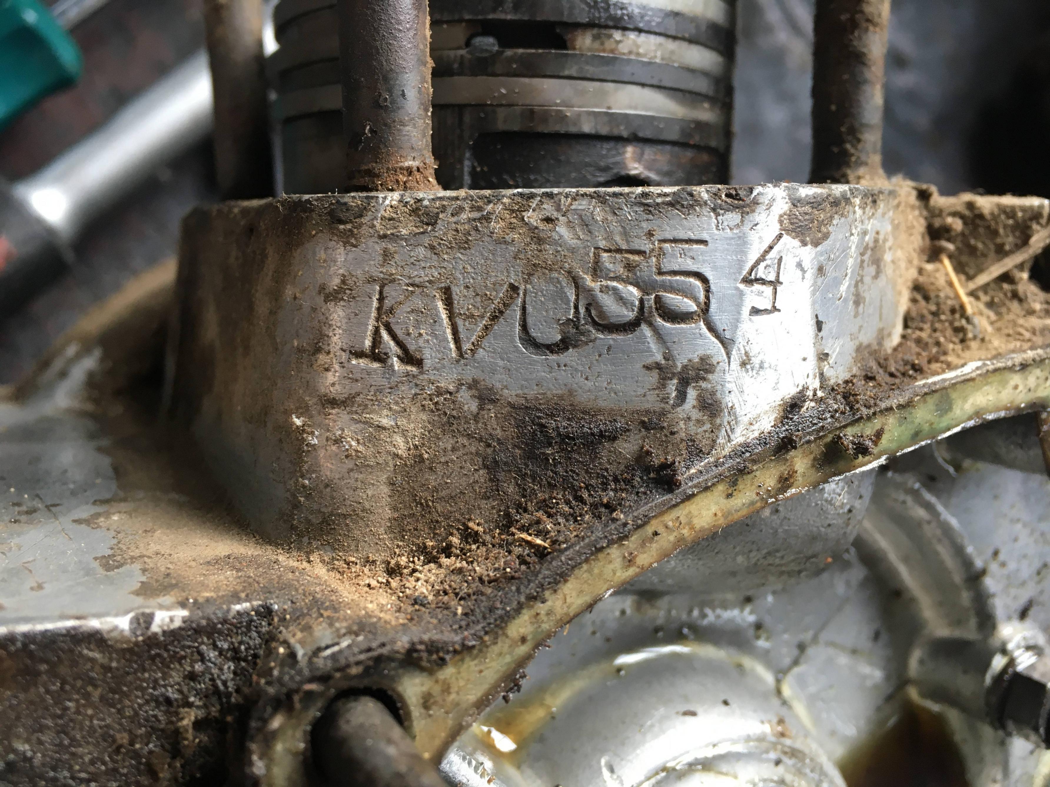

      Second post - engine number 2:

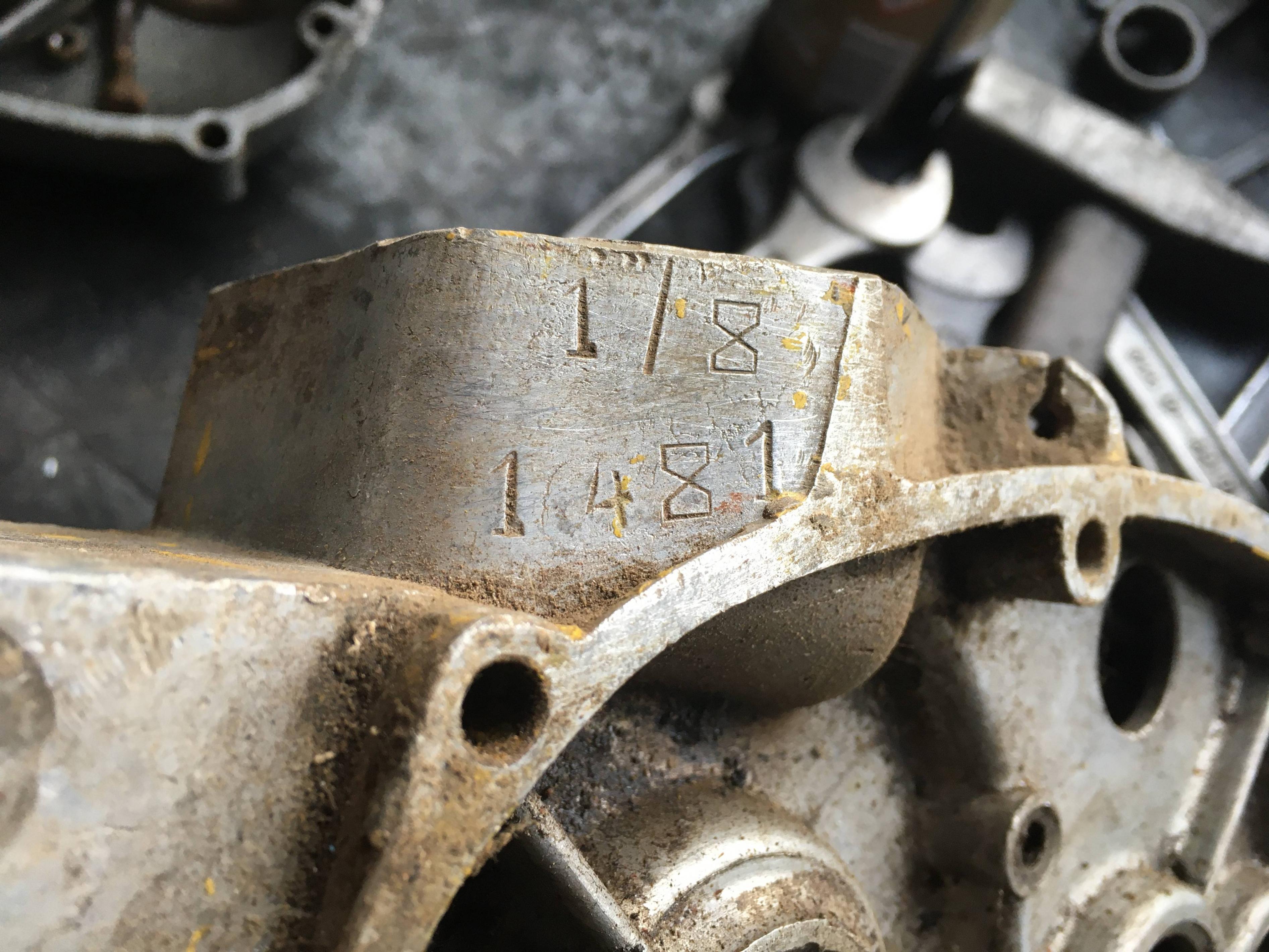

      NUMBERS/számok:
      1 half: 230635
      2 half: 246743
      First and second photo shows engine numbers. They are different - not original halves?
      Third photo shows cover - I guess that it is from 125/49.

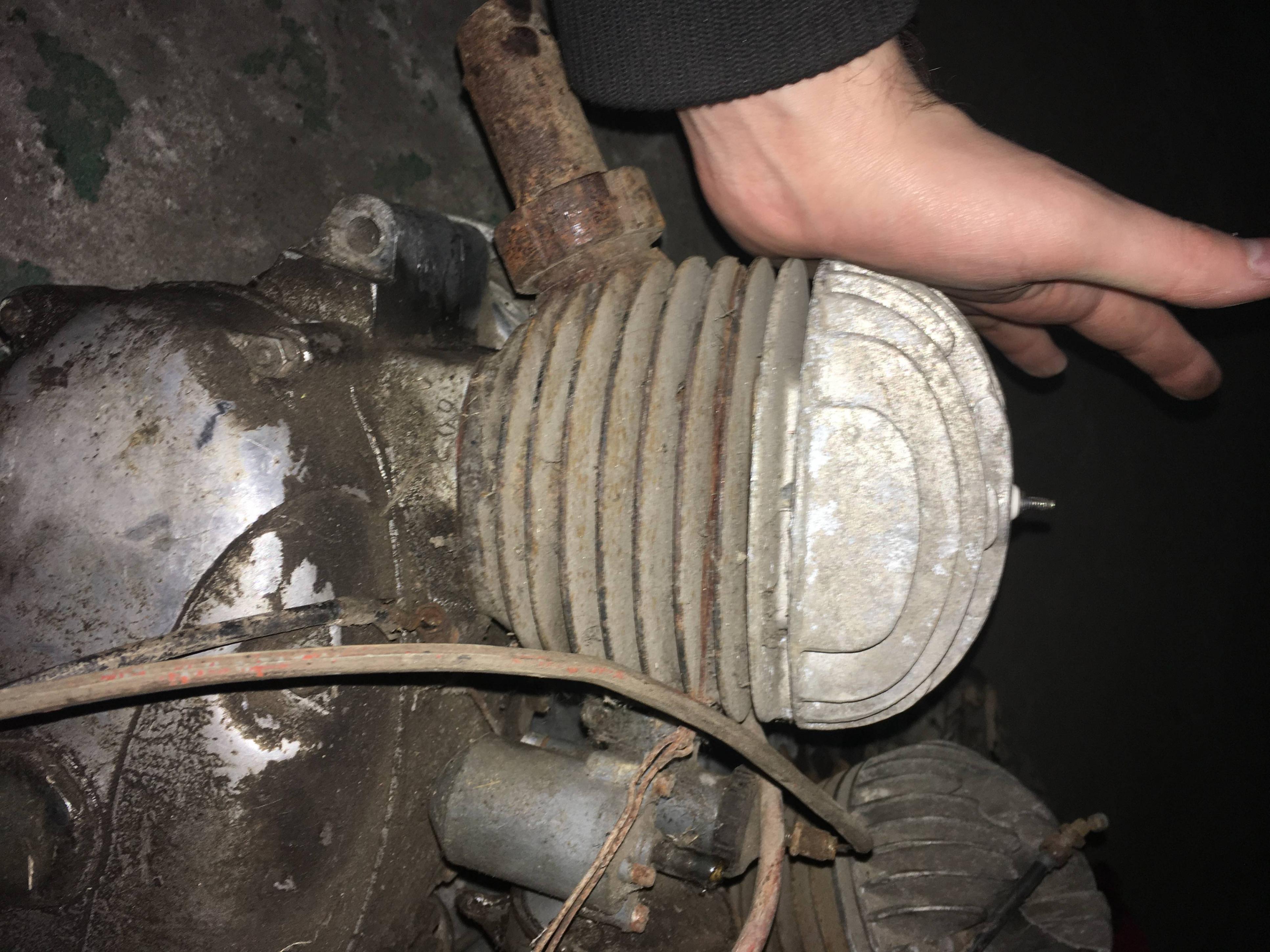

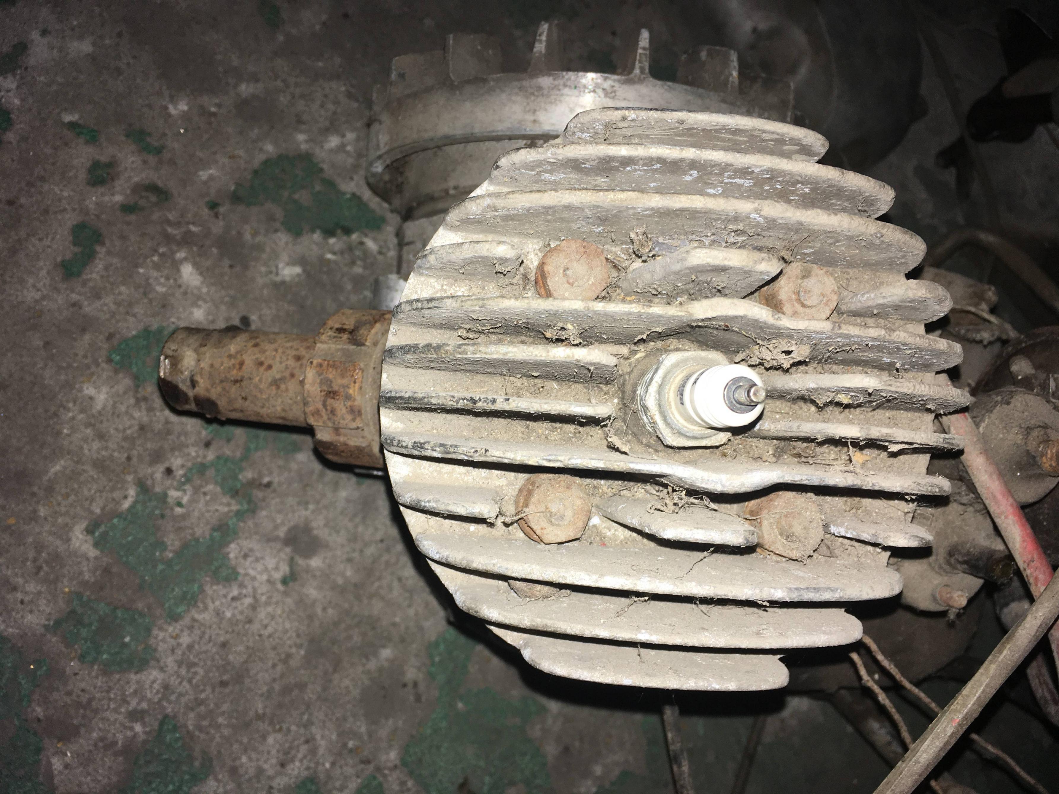

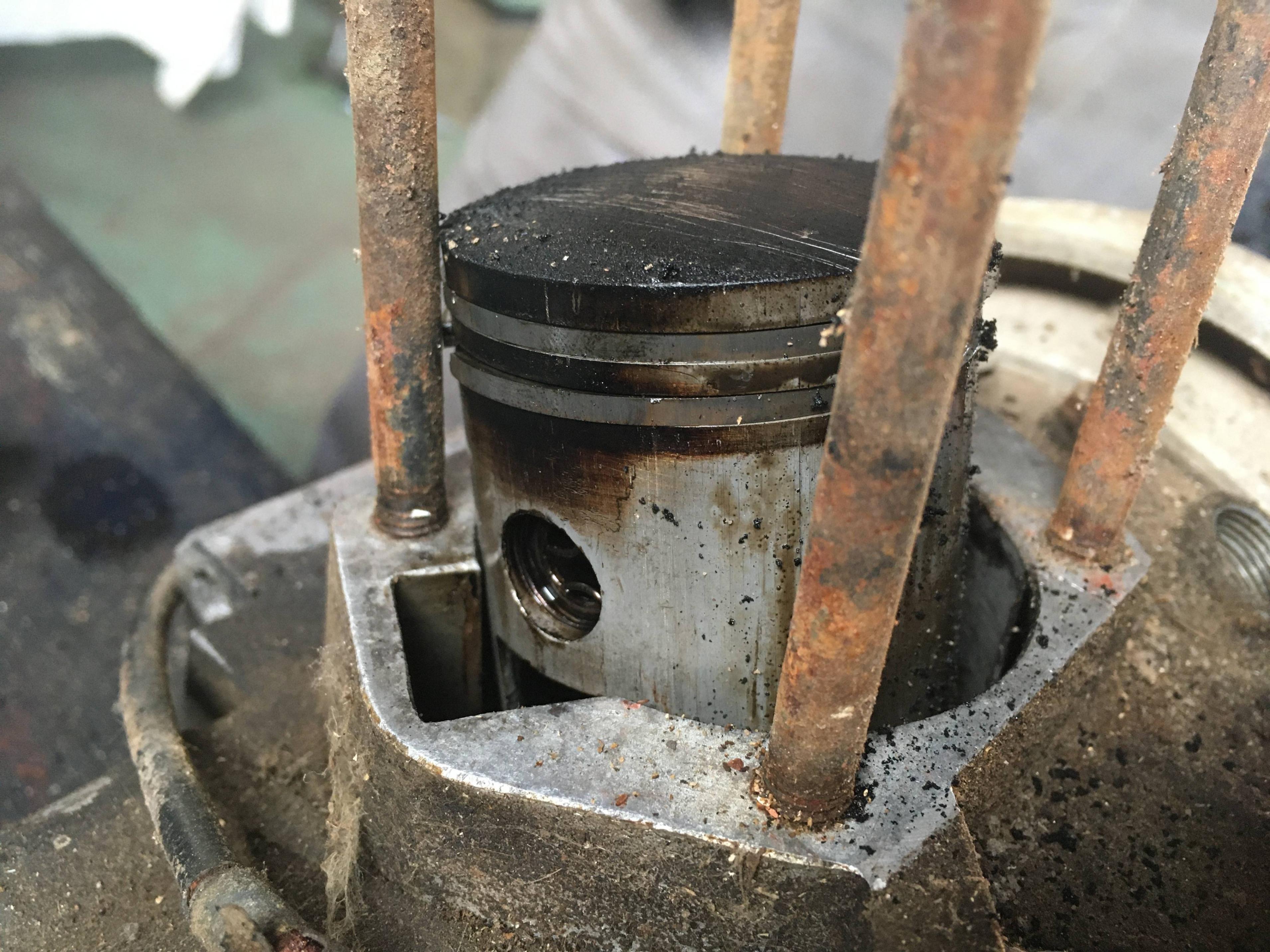

      Fourth photo shows cylinder and head of cylinder - I guess that is is from 125/49 too.
      This engine looks like original 125/49 in all details (karburátor is from 49 too). If I am wrong tell me
      Utoljára szerkesztve a következő által: Wild; 2020 dec. 15, 21:20.

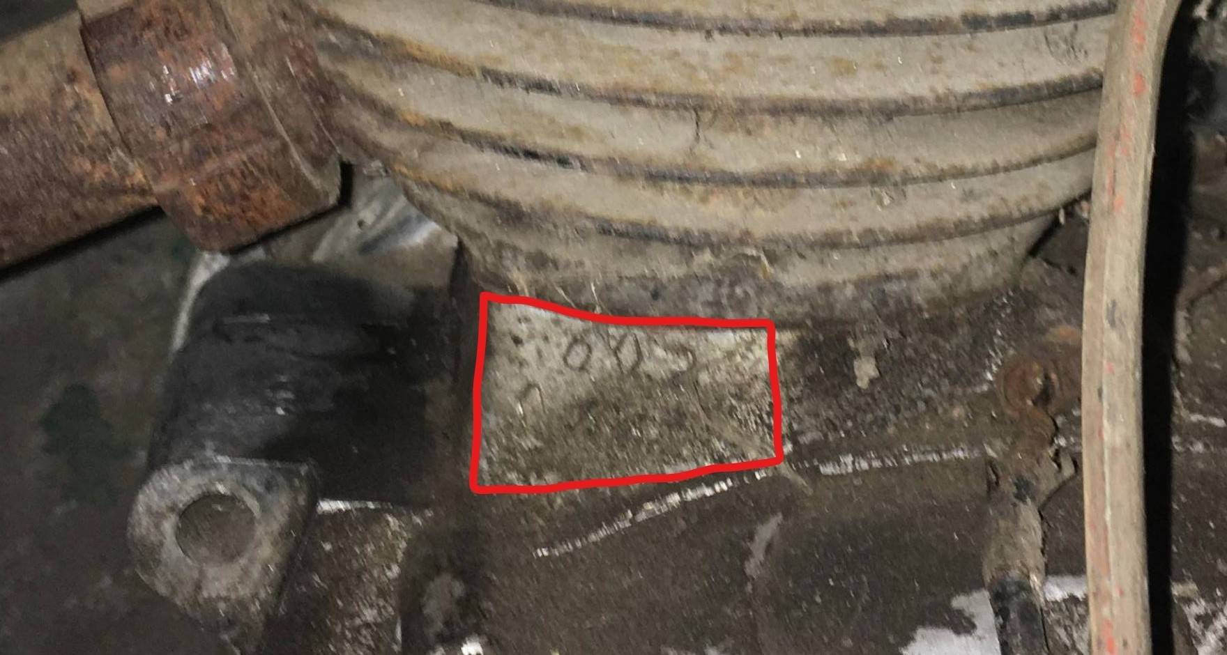

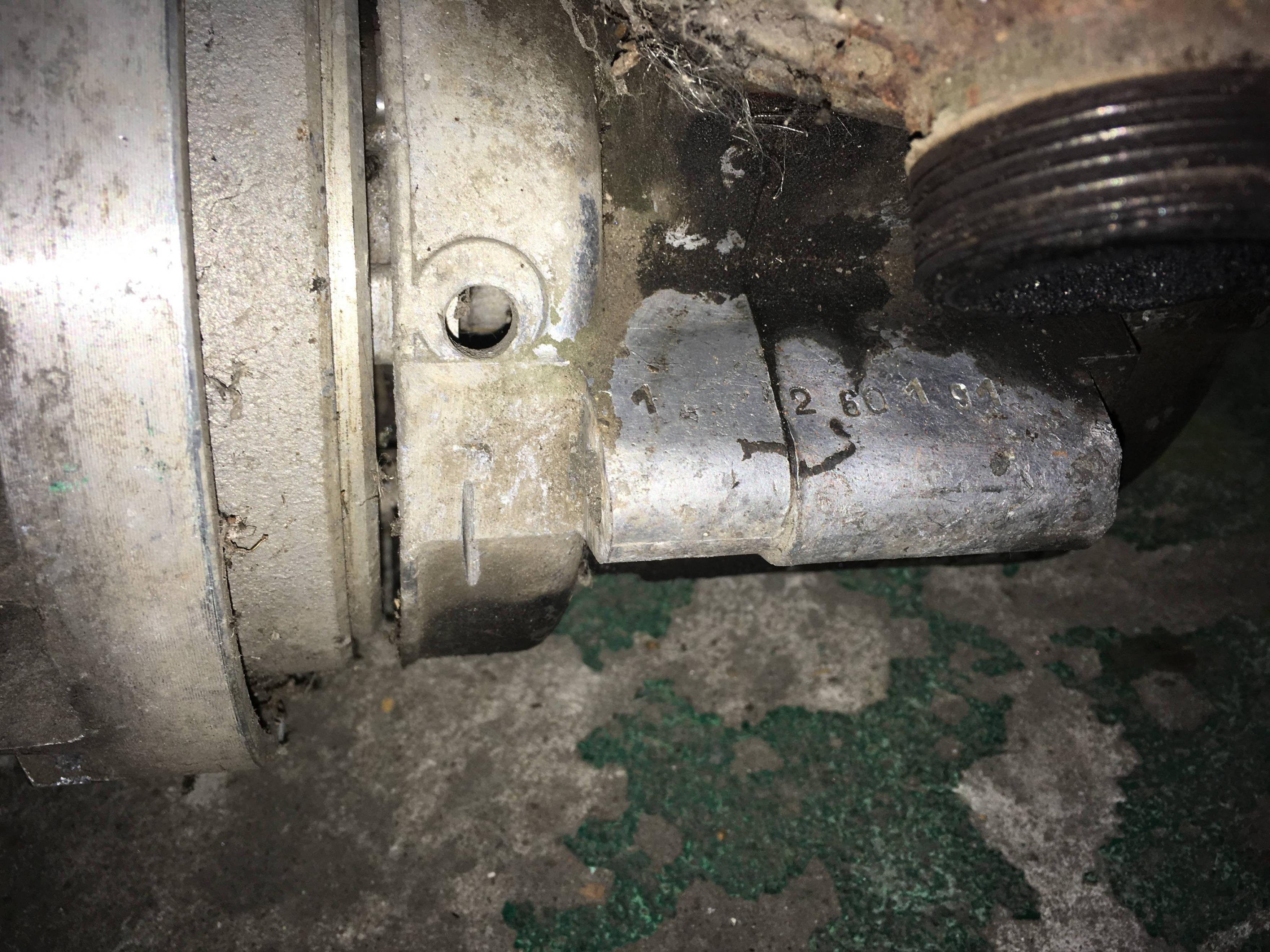

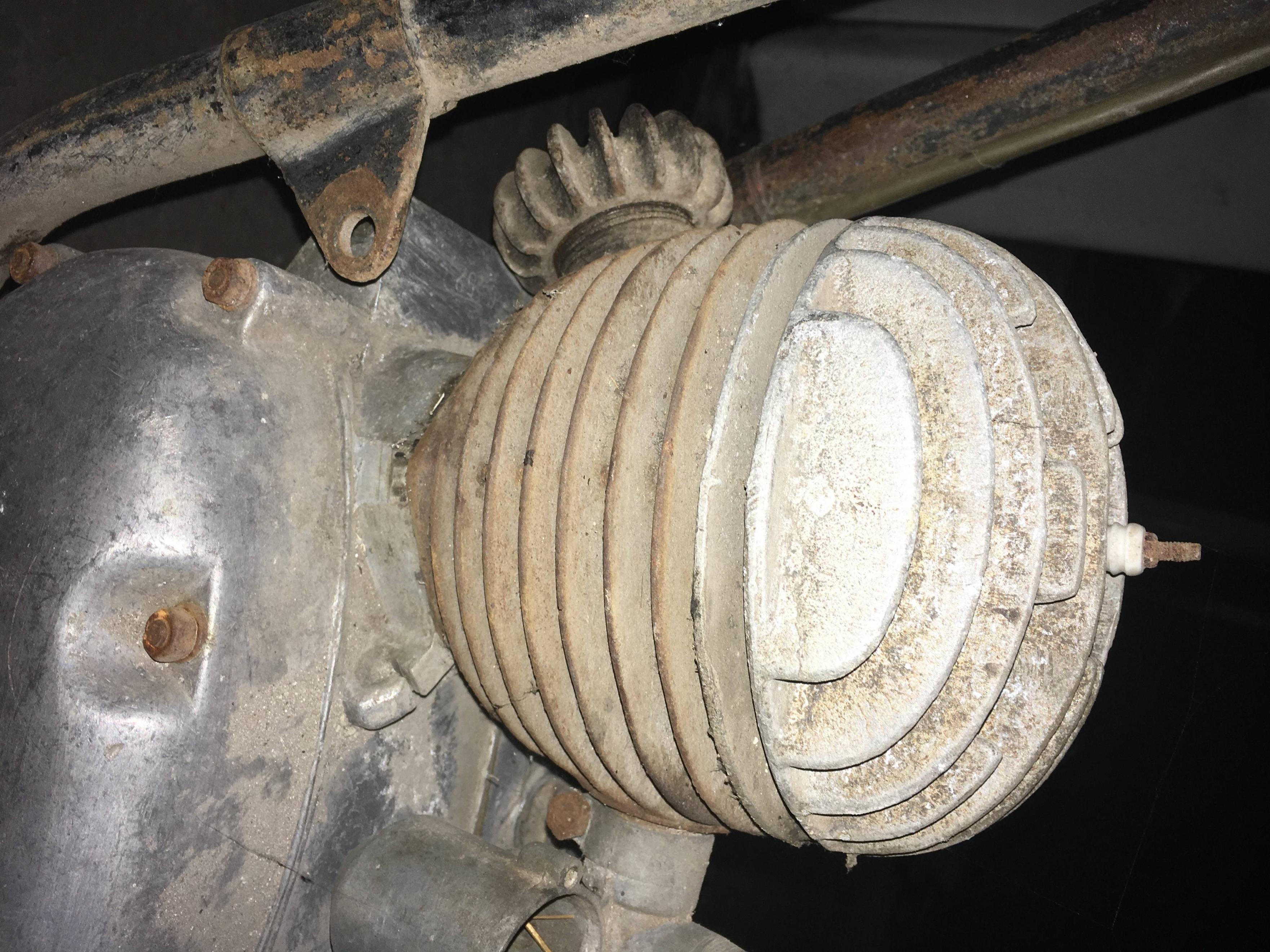

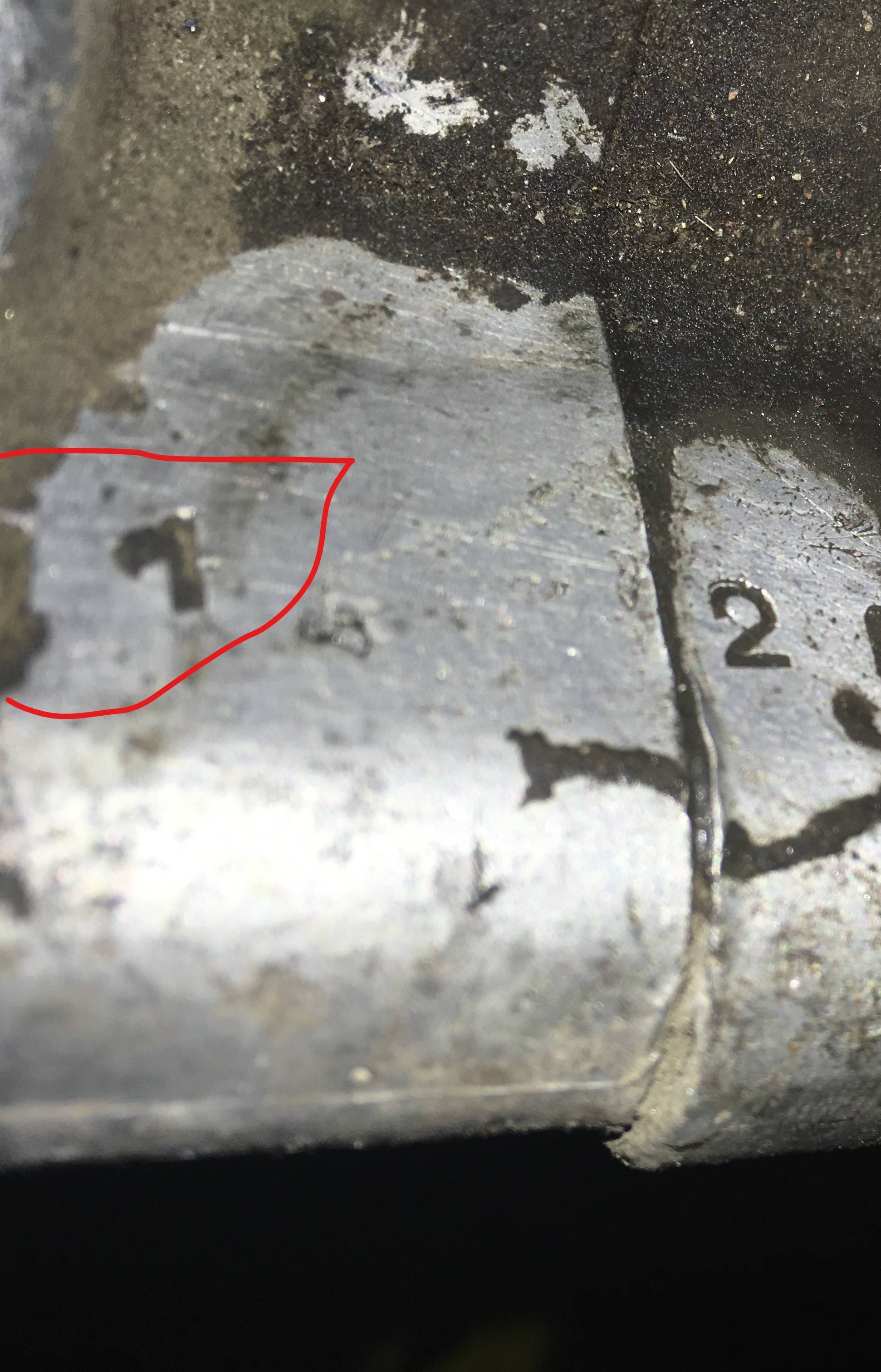

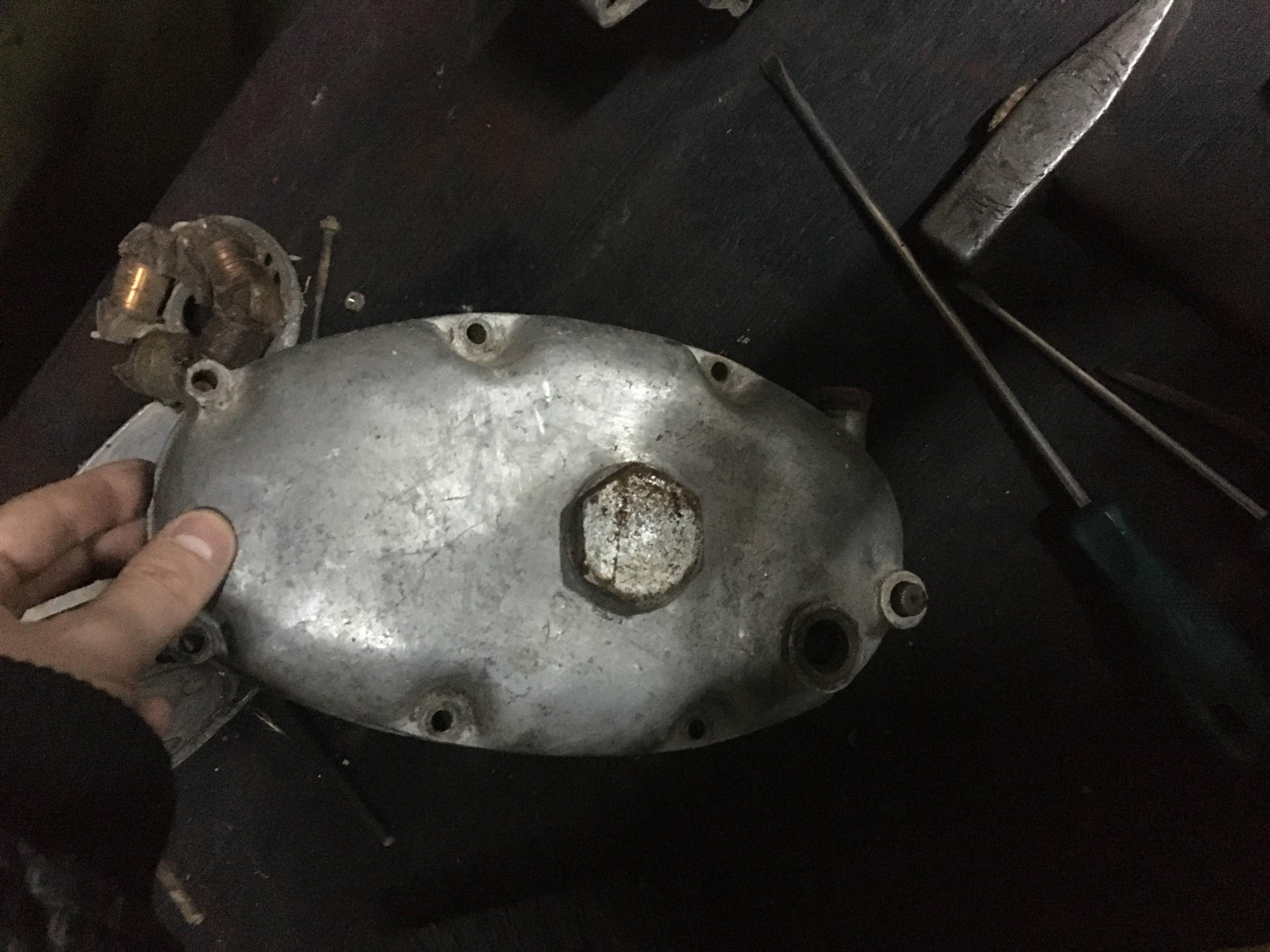

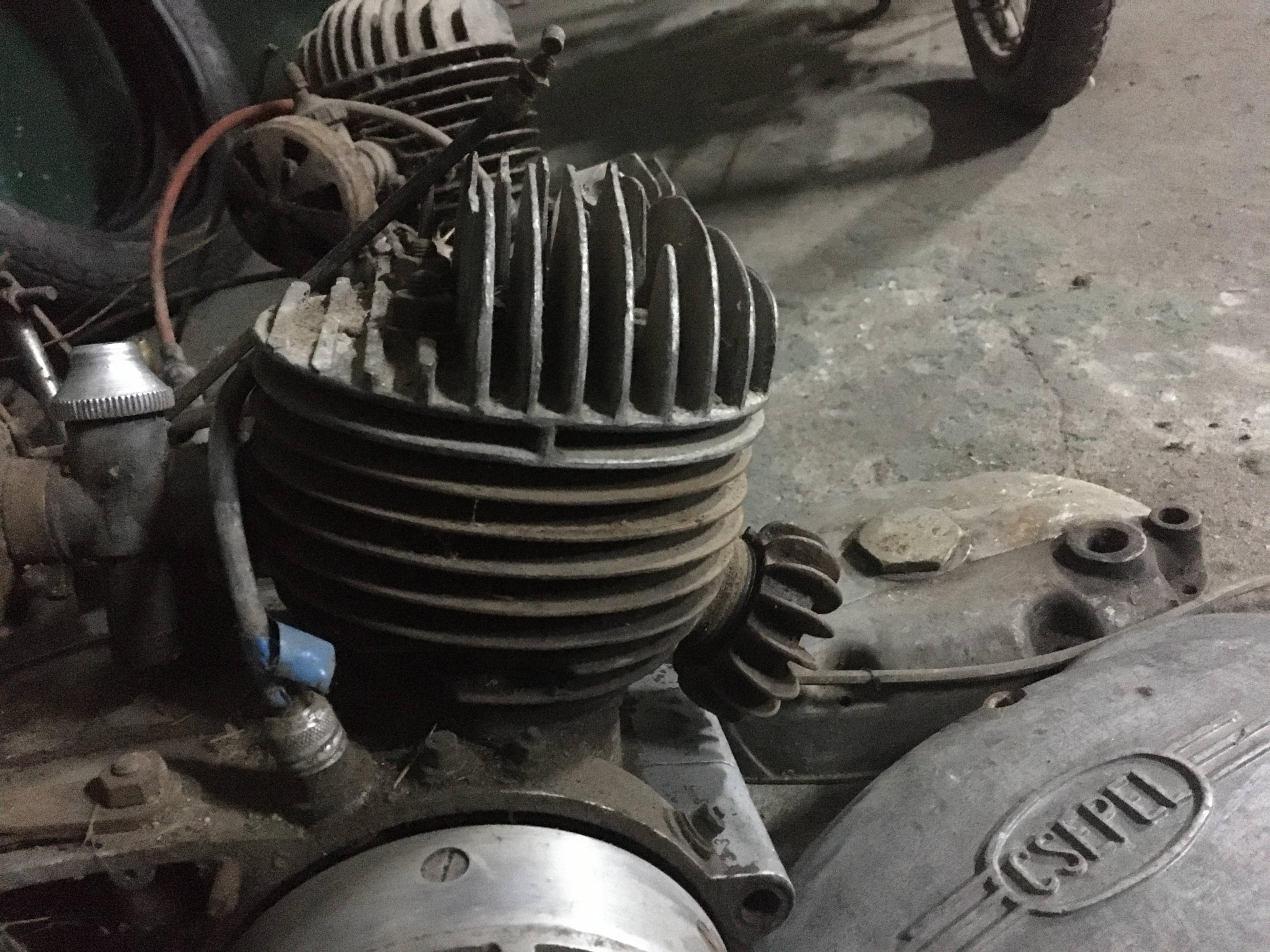

        Third post - engine number 3:
        NUMBERS/számok:
        1 half: 260191 - there is only on number - this looks like 1956 Csepel-Danuvia engine - maybe they had only one number.
        First photo shows engine numbers.
        Second shows cover which is from Csepel-Danuvia 1956.
        Third and fourth photo shows (now it is important) - in my opinion they show cylinder and head of cylinder from 125/49. Cover and all from Danuvia and cylinder from 49?
        Also exhaust nut is different from 49. Is it from newer ones?
        Karburátor is from Csepel -Danuvia too.

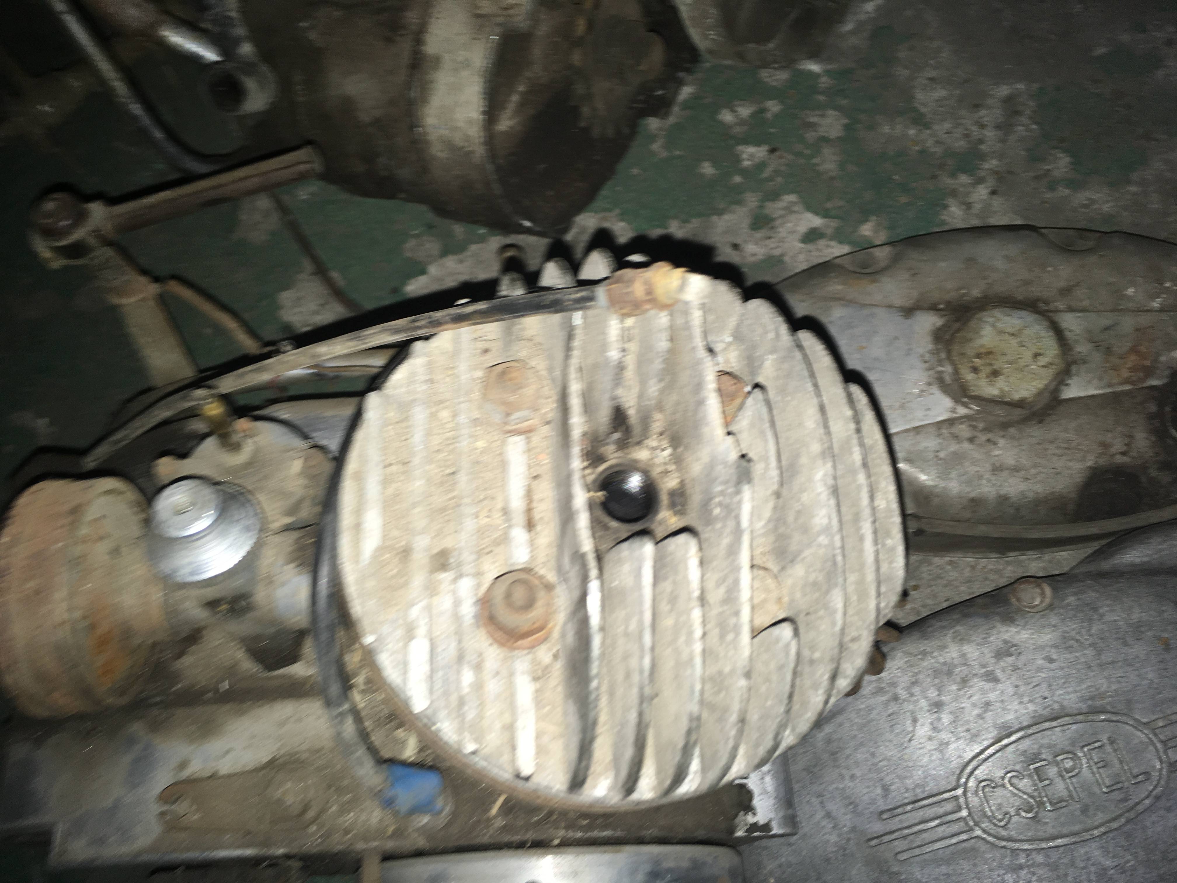

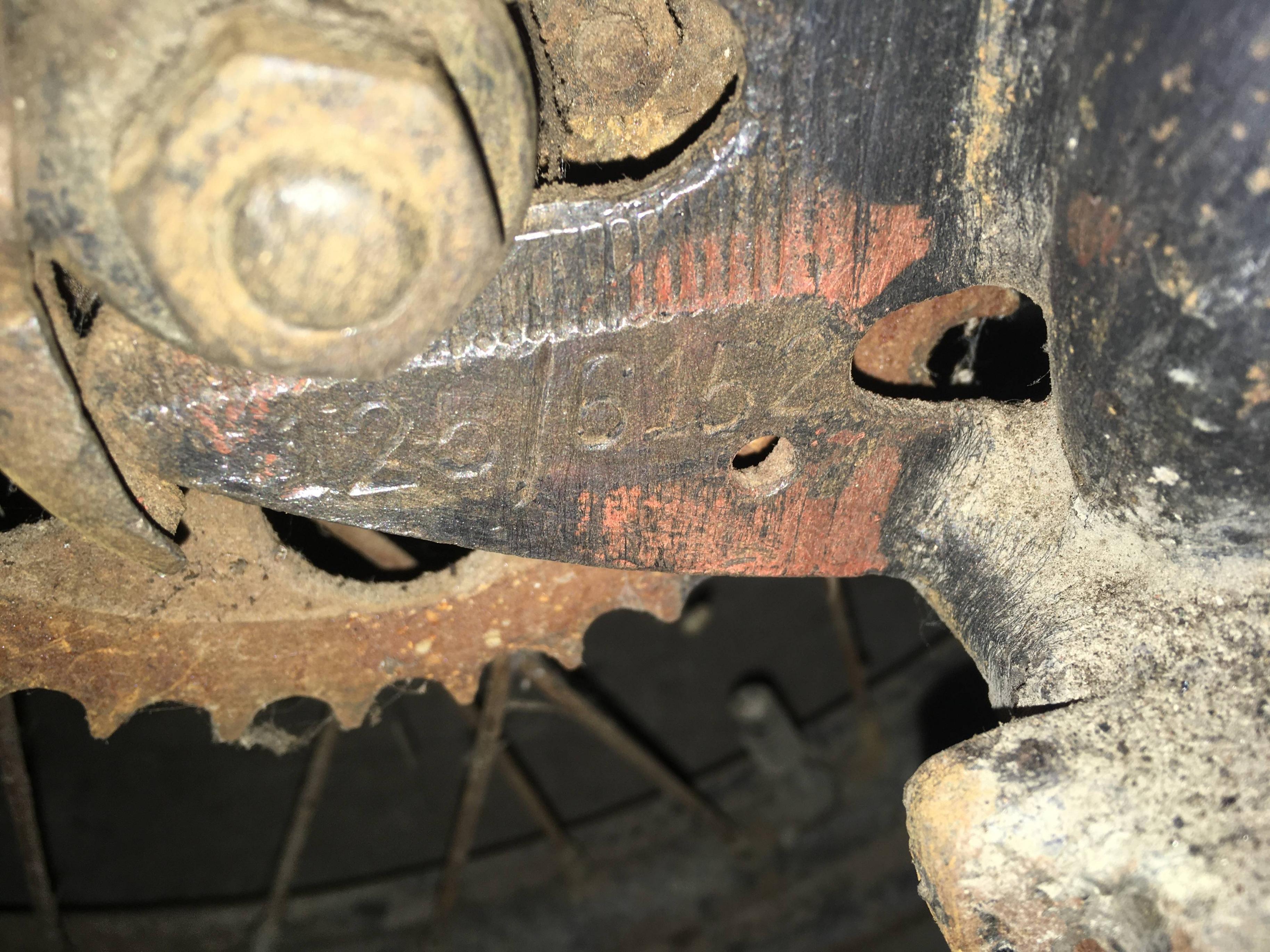

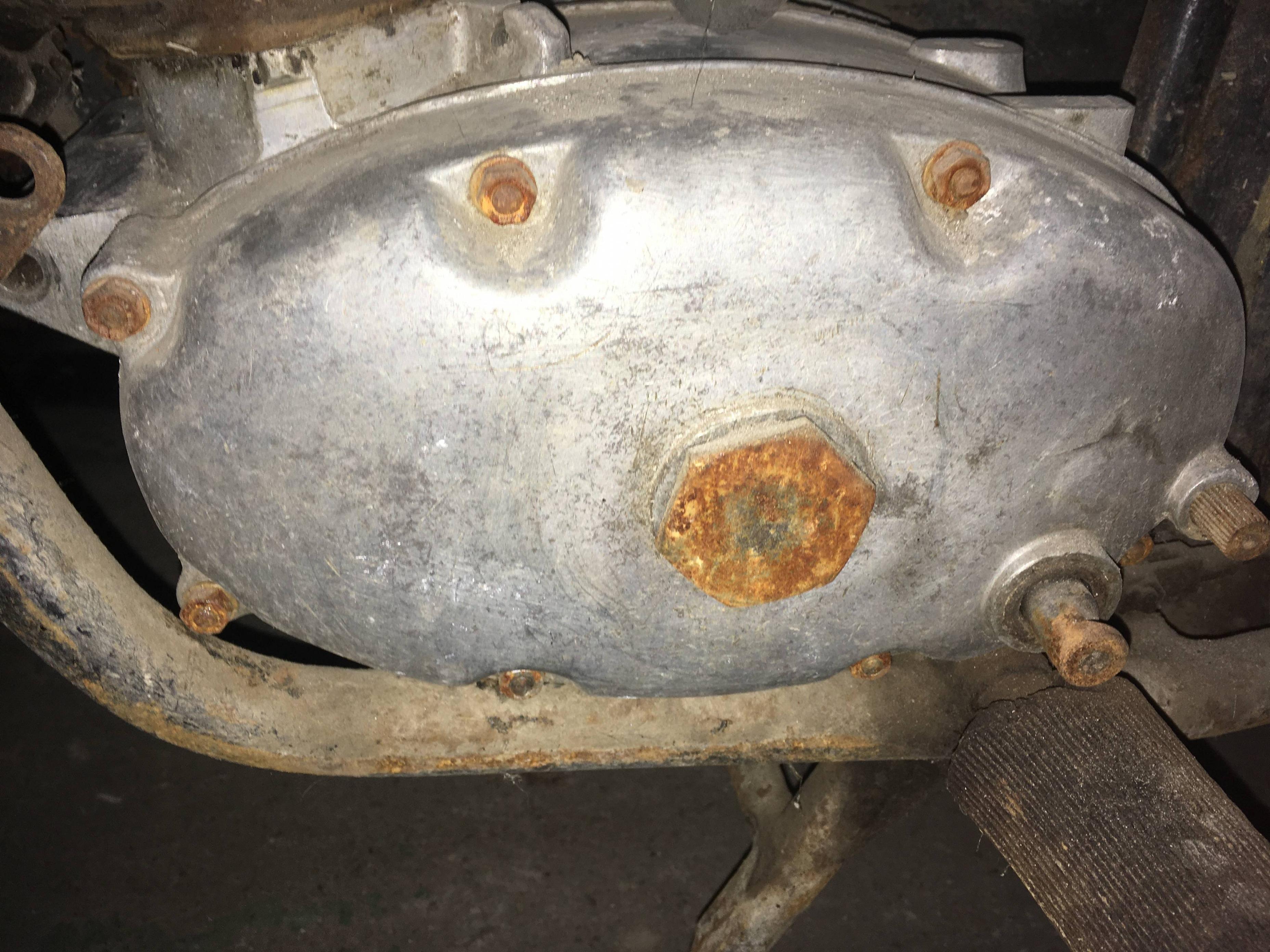

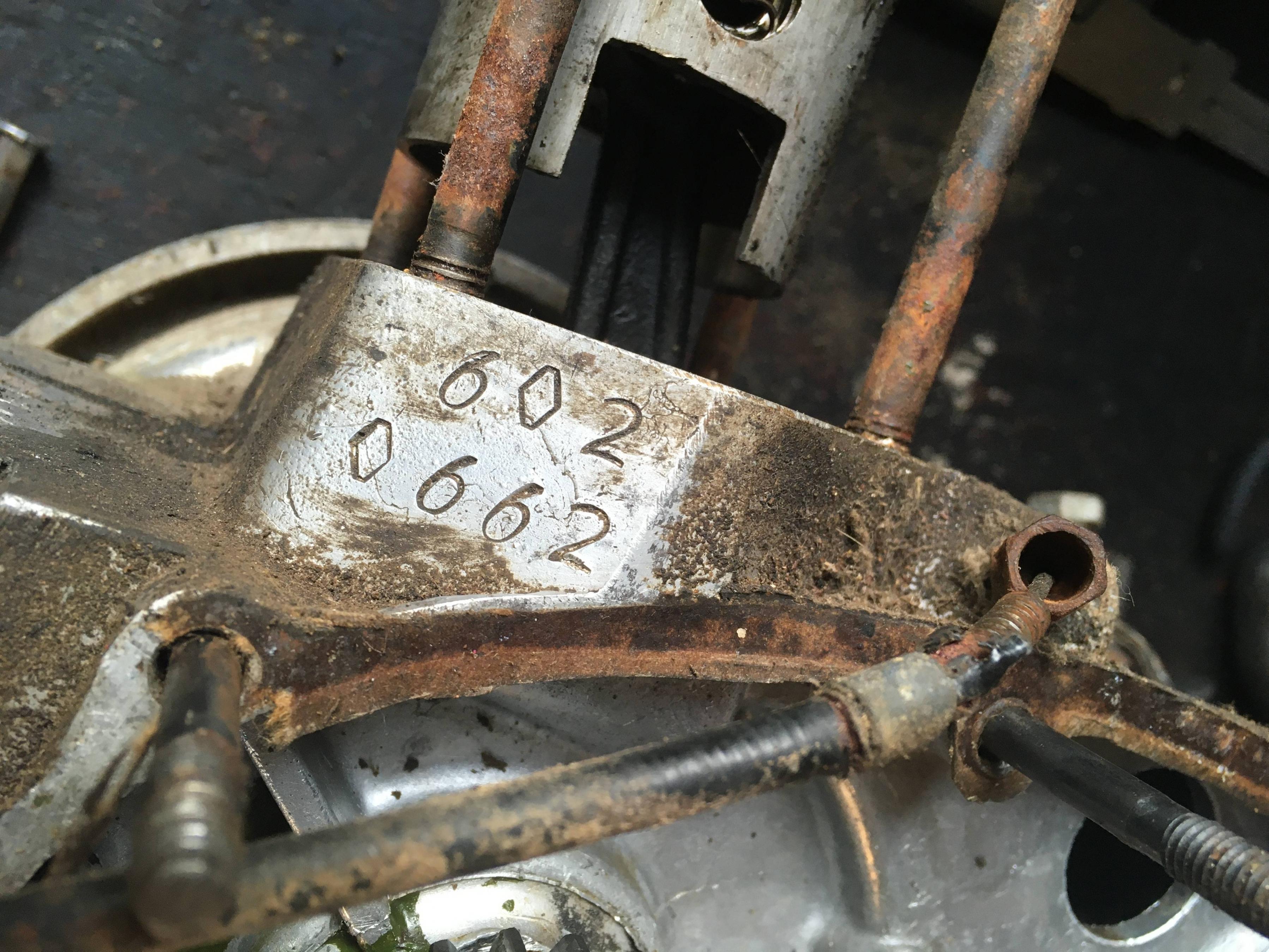

          Fourth post - engine number 4 (from my motorcycle):

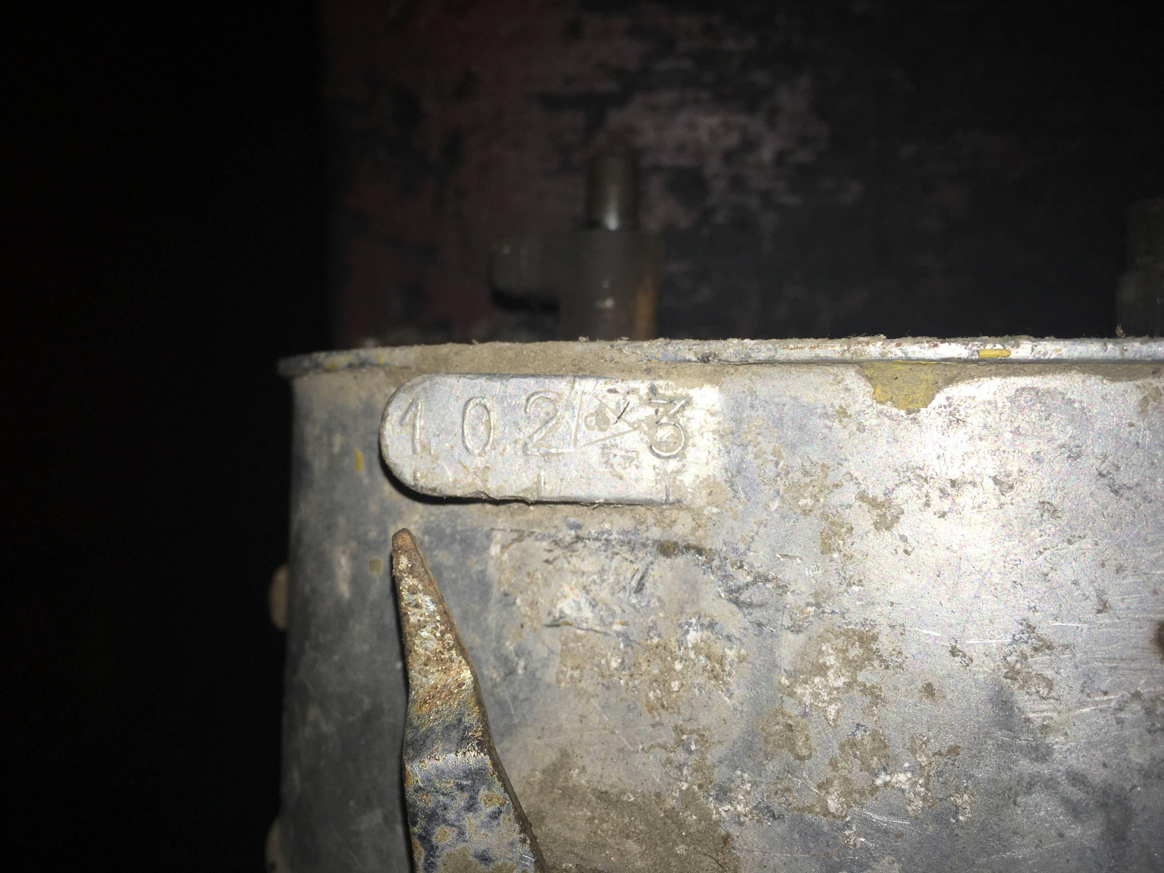

          NUMBERS/számok:
          1 half: 6152 - the same numbers on both halves
          2 half: 6152
          frame: 6152
          Second shows frame numbers (they are the same like on engine wooow).
          Third photo shows cover from 49.
          Fourth photo shows cylinder and head of cylinder.
          No questions for that I think

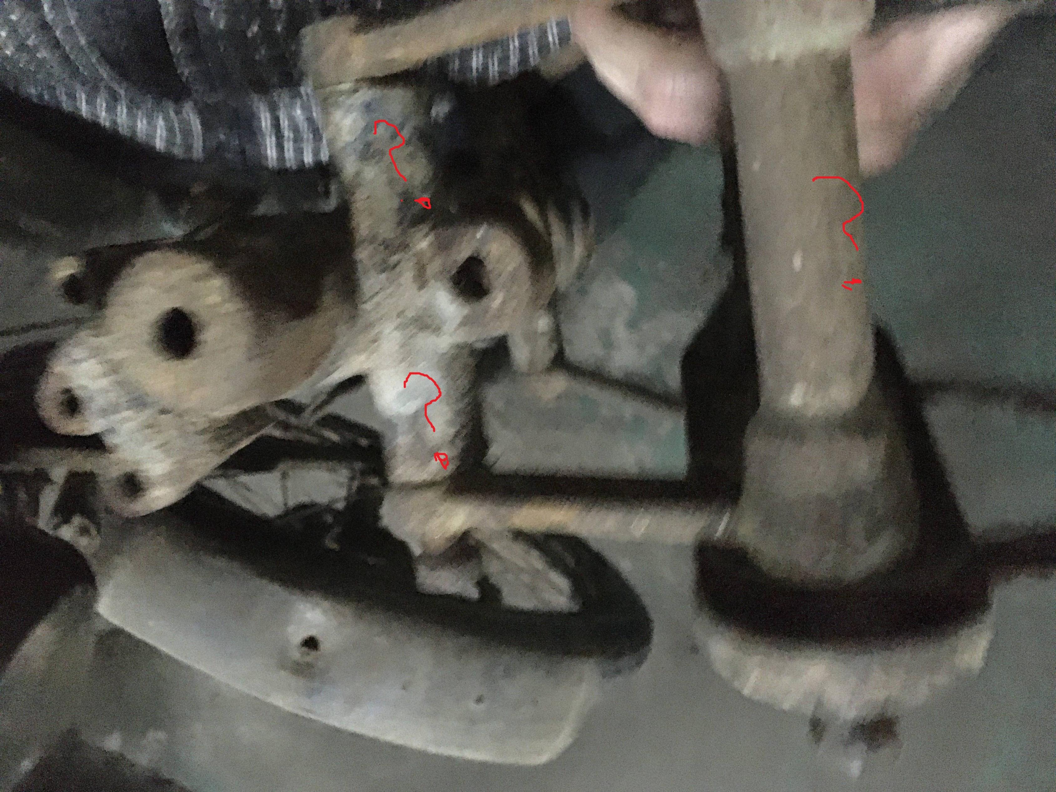

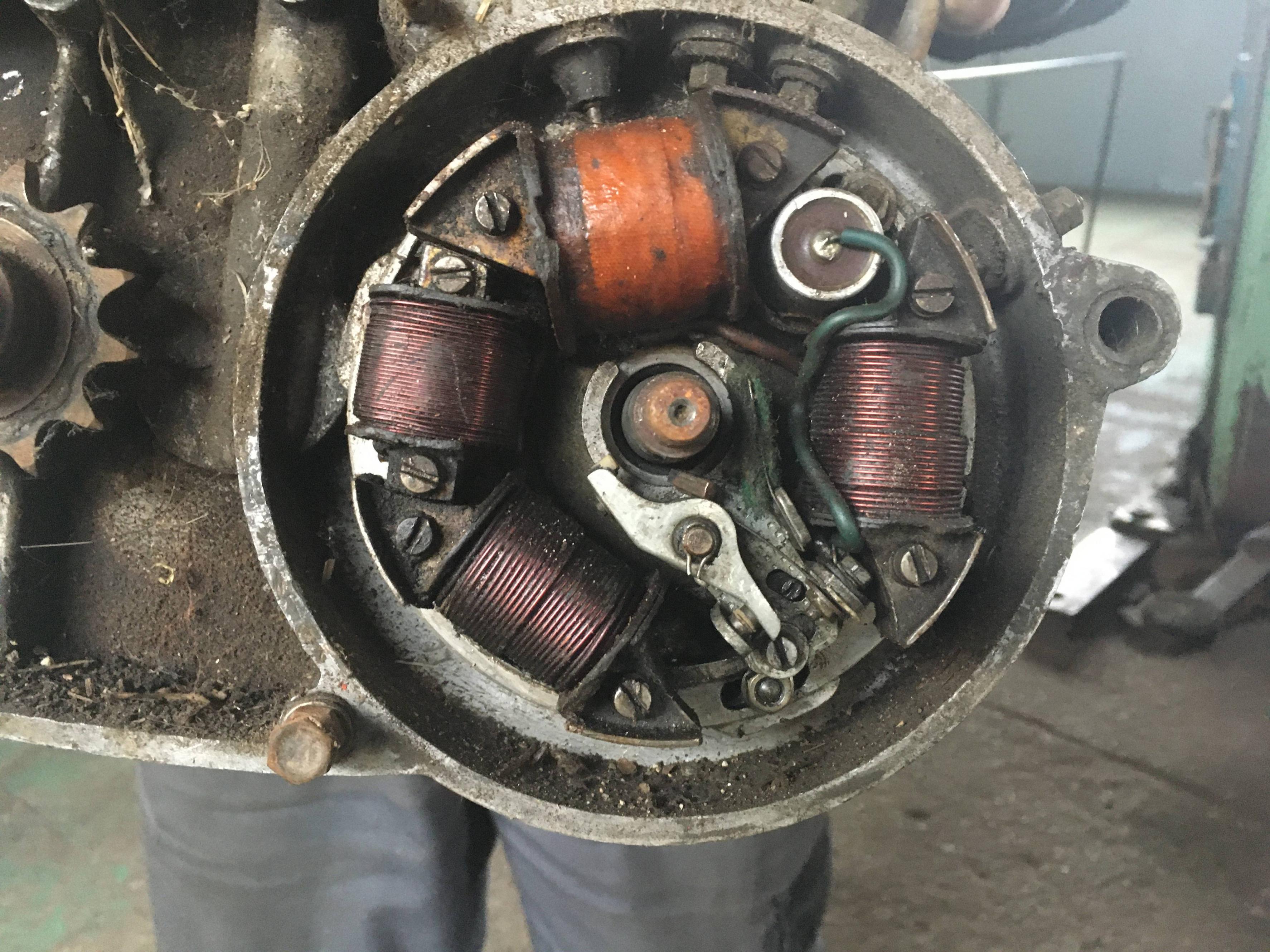

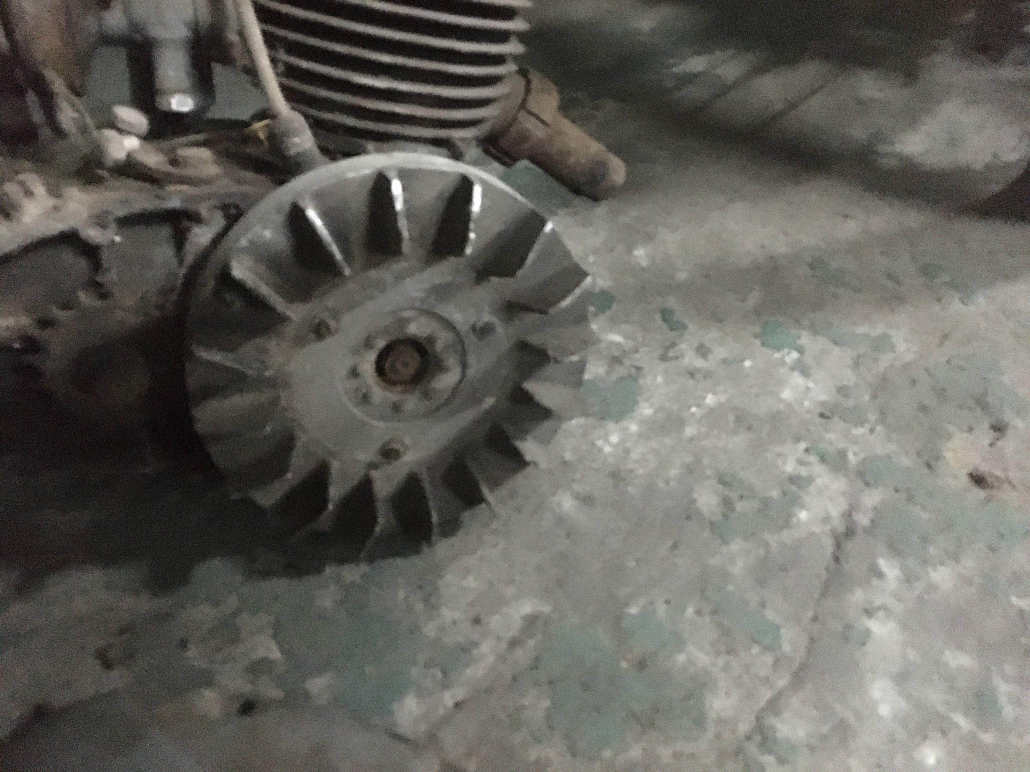

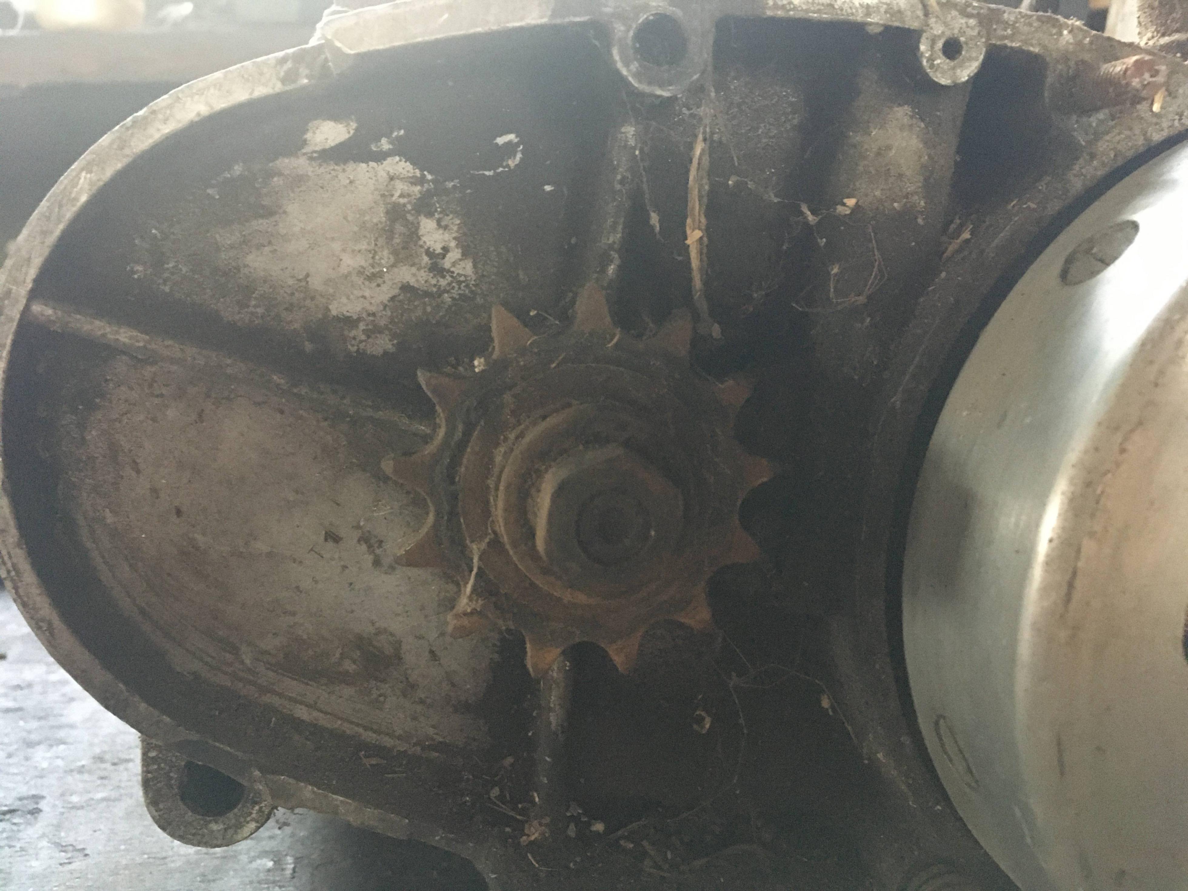

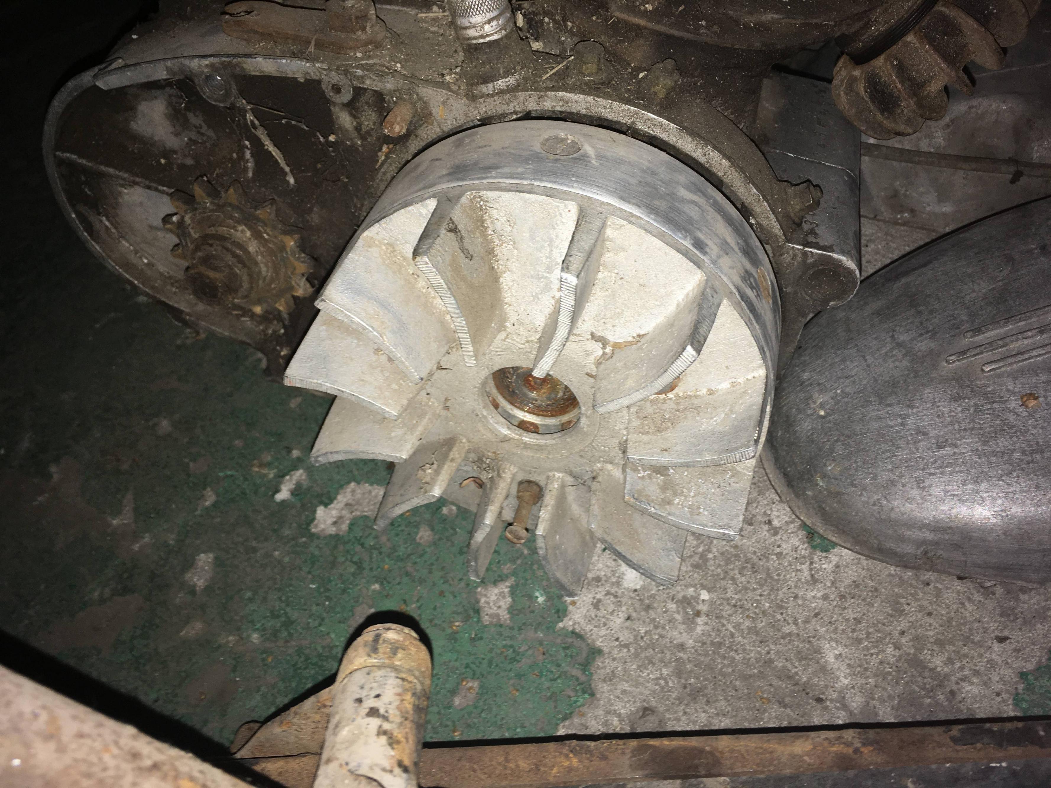

            Fifth post - last one

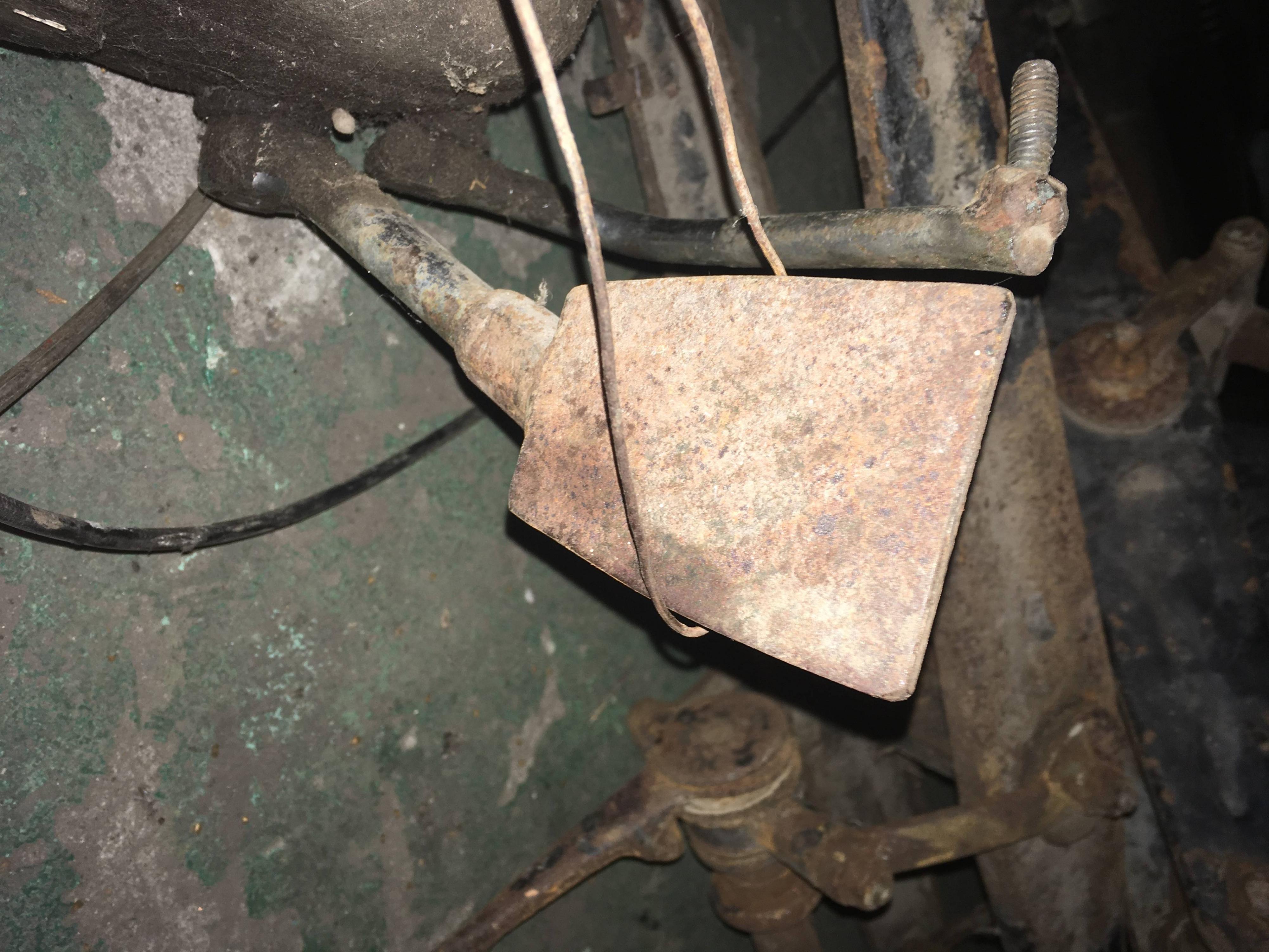

            First and second photo shows strange elements. I think that they were mounted when someone wanted to use engines like pomps (from jól for example?). That parts can be from old machine. Maybe someone is looking for that parts?

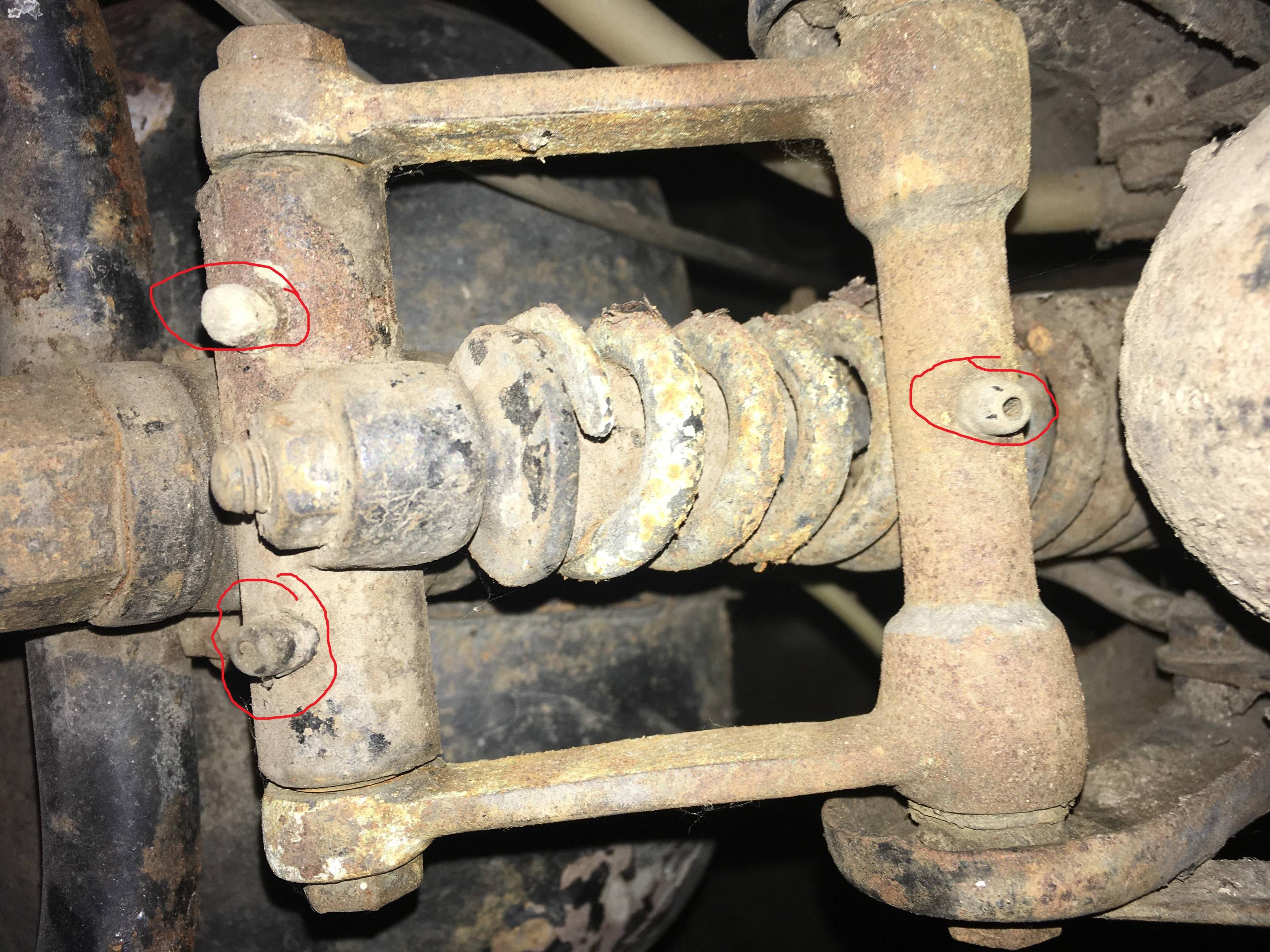

            Third and fourth photo shows x2 lemezvillás (old sort of telescopes) I haven't got knowledge about that, but this type has 100/48 too. First lemezvillás has parts which I highlighted with red circles.
            Second haven't got that. Maybe it is that key difference?

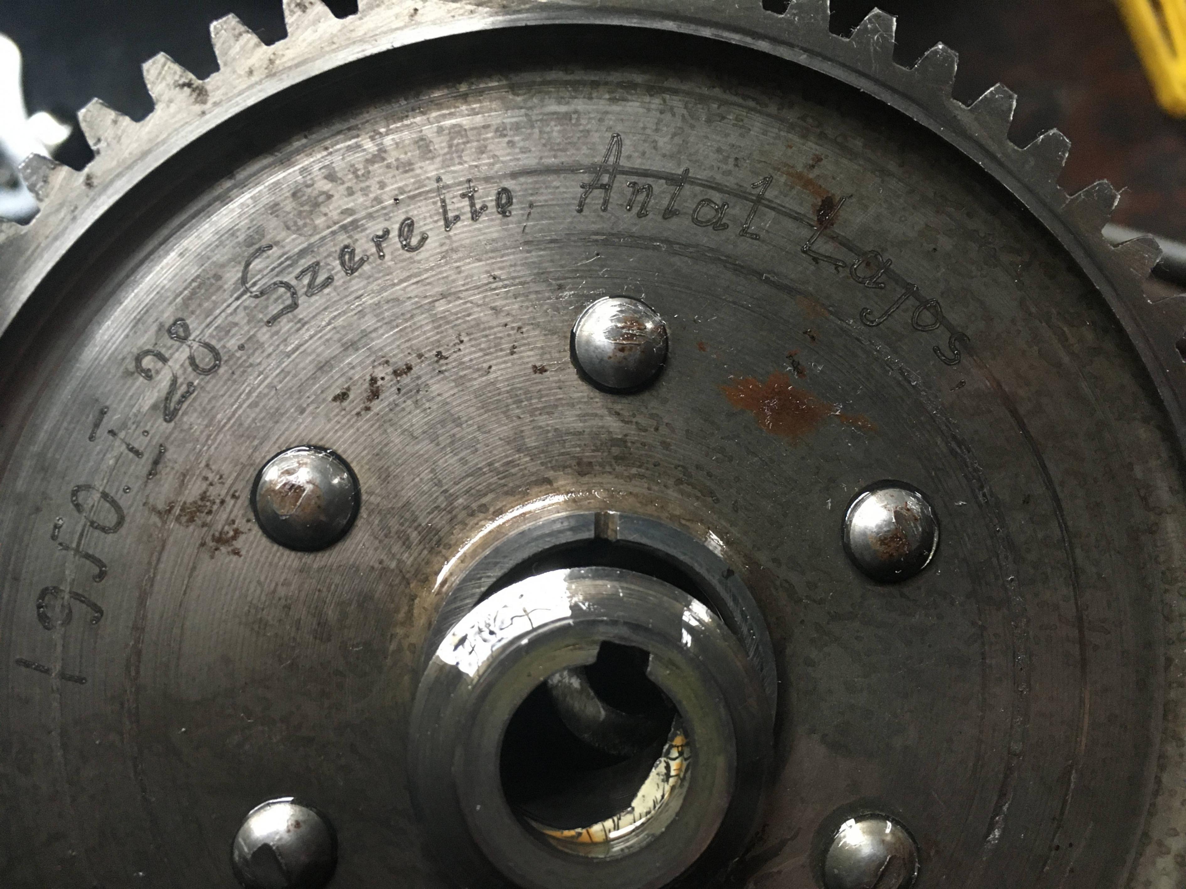

            Last photo shows strange element (uszony). Maybe this is from old machine too and someone is looking for that?
            It is a lot of that. If you want to answer please note which engine you are describing.
            Thanks guys, I hope that numbers will be helpful.
            Wild
              Hello Marcin,
              I answer for the fourth post.
              This engine has got 6152 block part identifier, but this isn't the engine number. You will find the engine number under the cylinder on the left:
              Click image for larger version  Name:	blokkszám.jpg Views:	0 Size:	164.8 KB ID:	225829 This one in the 3th post is made in Mai 1960 perhaps(60/5?).
              In the Csepel factory, all motorbikes frames and engine numbers matched. But the part identifiers with the frame are not. I think your 4th engine numbers are post factum. I'm interested in the real engine number.
              second post: Engines, which have different half numbers may be parts in the future. Unusable each other.
              1-2-3 engines are Danuvia engines. The exhaust nuts that different from your /49 engine nut are also homemade.
              The strange elements report, that engine was working as a home made hoeing machine engine after motorbike engine.
              The uninjured cylinders and heads are fits for your /49 modell. For example in the 3th post.
              This engine cover in the first and second post also.​

              Helló Marcin!
              A negyedik hozzászóláshoz: ennek a blokknak 6152 a párosítószáma, de ez nem a blokkszáma. Azt a henger alatt bal oldalon találod.
              A gyárban a motorok vázszáma egyezett a blokkszámával, de a blokkpárosítóval nem. Szerintem a negyedik blokkodon ez a beütés utólagos. Érdekelne a valódi száma.
              Második hozzászóláshoz: azok a blokkok, amelyeknek nem egyezik a párosító számuk csak alkatrésznek jók.
              Az első három blokkod Danuviához való. Az eltérő kipufogó hollanderek házilagos készítésűek.
              A furcsa alkatrészek azért vannak a blokkokon, mivel házilagosan épített kapálógépekben szolgáltak utoljára.
              A sérülésmentes hengerek és hengerfejek jók lesznek a Csepeledre, pl a 3. blokkon levők. Az első és második hozzászólásban szereplő kuplung fedél szintén.
                I think the second identification number are under the oil mud. And it pass.
                magyarul:
                - Itt csak egy párosító számot látok, D-Csepel blokknak tűnik, lehet, hogy ezeknek csak egy számuk volt?
                - Szerintem ott lesz az olajsár alatt a másik szám is ami passzol.
                  The 100/48 and 125/49 front suspension not the same, only at a glance. I think each could have been /49 part.
                  magyarul:
                  - A 3. és 4. kép két lemezvillás alkatrészt mutat, nem nagyon értek hozzá, de 100/48-nak is ilyen villája volt. Az elsőn bekarikáztam, ami a másodikról hiányzik. Talán ez a két típus közötti különbség?
                  - A /48 és /49 első villája csak ránézésre egyezik. Szerintem mindegyik villád /49 Csepelhez való.

                    #39
                    This one is made in Mai 1960(60/5?)
                    It is strange in my opinion, because 125/49 was made in end of 48 to 51. So how engine could be made in 60? I will find numbers of this fourth engine tomorrow.
                    You mean that there can be problems with registration of motorcycle with that different numbers?
                    So they are Danuvia engines but with 125/49 cylinders, aren't they?
                    second post:
                    Are you sure that it is Danuvia engine? Maybe halves are from Danuvia but with 125/49 cover? Strange
                    I will do it tomorrow Rest numbers are good? Only fourth engine is wrong?
                    I have third one, but it is the same like that two suspensions. So I have to find differences between 48 and 49.

                      #40
                      Wild eredeti hozzászólása Hozzászólás megtekintése
                      Danuvia 125 was made from 1958 to 1966. The engine molding was same as Csepel 125.
                      No, I mean that different engine halfs have got different bearing bores. They will not face each other. In the factory the bearing bores were drilled when the halfs were facing each other.
                      This parts easy to replace, and the Csepel was better quality. Not only /49. The /50 and Csepel 125 T. Theese have got same cylinders and cylinder heads.
                      Are you sure that is is Danuvia engine? Maybe halves are from Danuvia but with 125/49 cover? Strange
                      The /49 more valuable. Salesman trick...
                      I will do it tomorrow ​ Rest numbers are good? Only fourth engine is wrong?
                      The one number that I can see is good. The fourth engine is an interesting case.
                      The most conspicuous difference between /48 and /49 front suspension is the lamp fixation.​

                        Hello!
                        This fourth engine was in frame of my motorbike. Karburátor is from 49, both covers from 49, cylinder and head from 49, so it is almost impossible that the molding could be from Danuvia. One scenario which is possible is that engines to 125/49 was made in 1960, but I doubt, because numbers are the same like on motorbike's frame.
                        This engine with one number had two numbers, but someone destroyed part with it. Photo shows that.
                        There is no more numbers on that engine. It is clean, so I could see all. I know that there are halves numbers, not engine - maybe during repairing I will find something
                        Utoljára szerkesztve a következő által: Wild; 2020 dec. 17, 19:48.
                          I answered yesterday the 1960 made engine to the 3th post. The engine in the 4th post is enigmatic. There are only two half identification numbers, which match the frame number.
                          The electrical outlets can be helpful to us. In the Danuvia motorbikes, which have battery there are 4 electrical outlet. From left to right the first is the ignition wire. The second is the stop wire. The third is the battery charging wire. (Csepel engines don't have this hole, because Csepel bikes don't have battery) The fourth is the lighting wire.
                          Yes, this engine block part identifier has became a victim of the hoeing machine.

                                I have numbers for you and I finally dismantle engines.
                                First photo (Danuvia/Csepel): 602 0662
                                Second (Danuvia/Csepel): KV 0554
                                Third (probably from 125/49): 1/8 1481
                                The most surprising - this engine in motorcycle was almost empty inside. And it is the only one which doesn't have numbers near cylinder. My prediction is - this 6152 which is on it was later done on both halfs and original number near cylinder was removed. I think that numbers on halfs were not originally the same like on frame, am I wrong?
                                1/8 1481 engine had all components from 125/49 (but empty inside) and numbers on halfs are 166367.. so.. Am I right that 6 digit numbers are on 125/49 engines too? Not only on Danuvia?
                                And i have more questions:

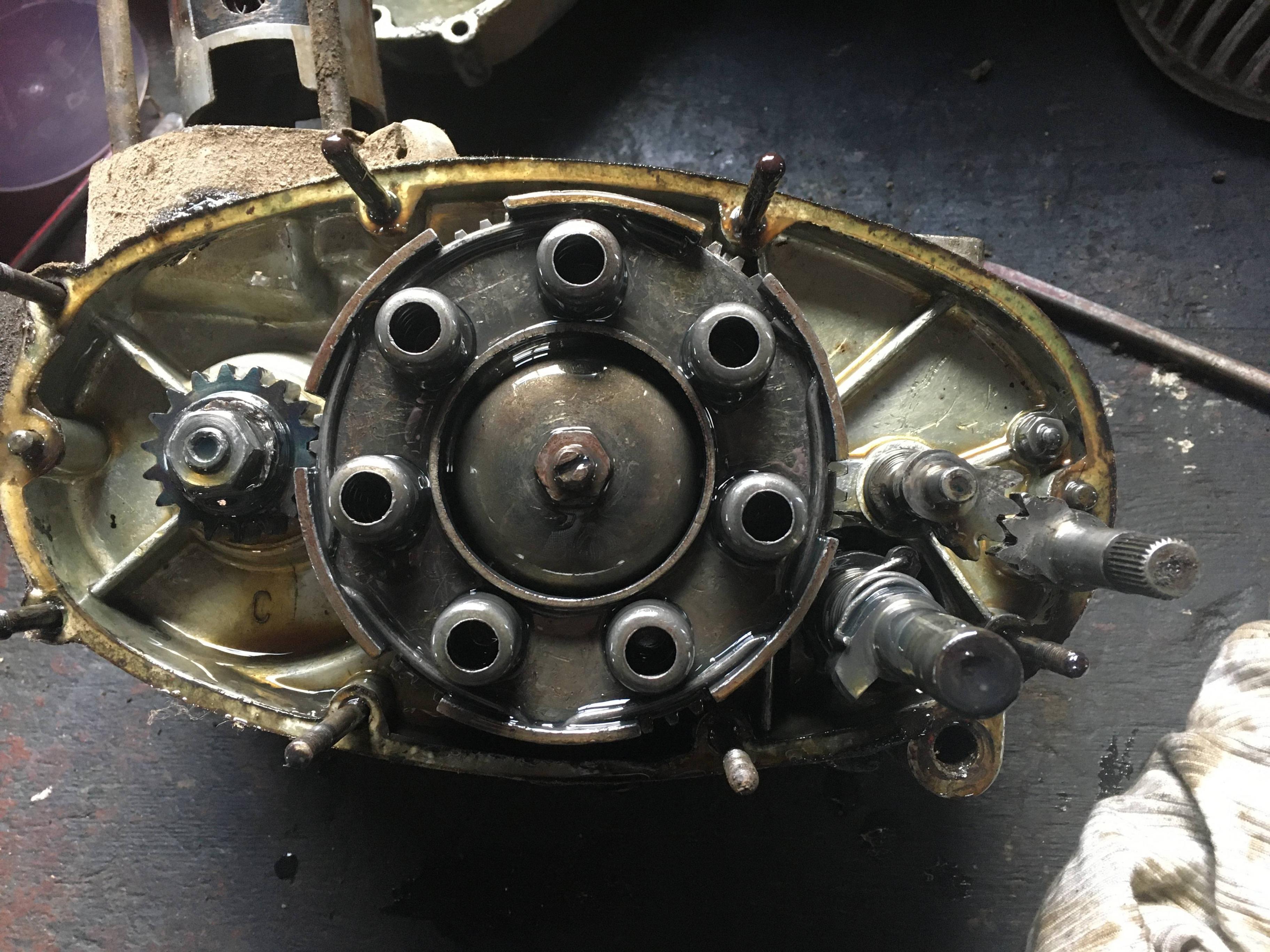

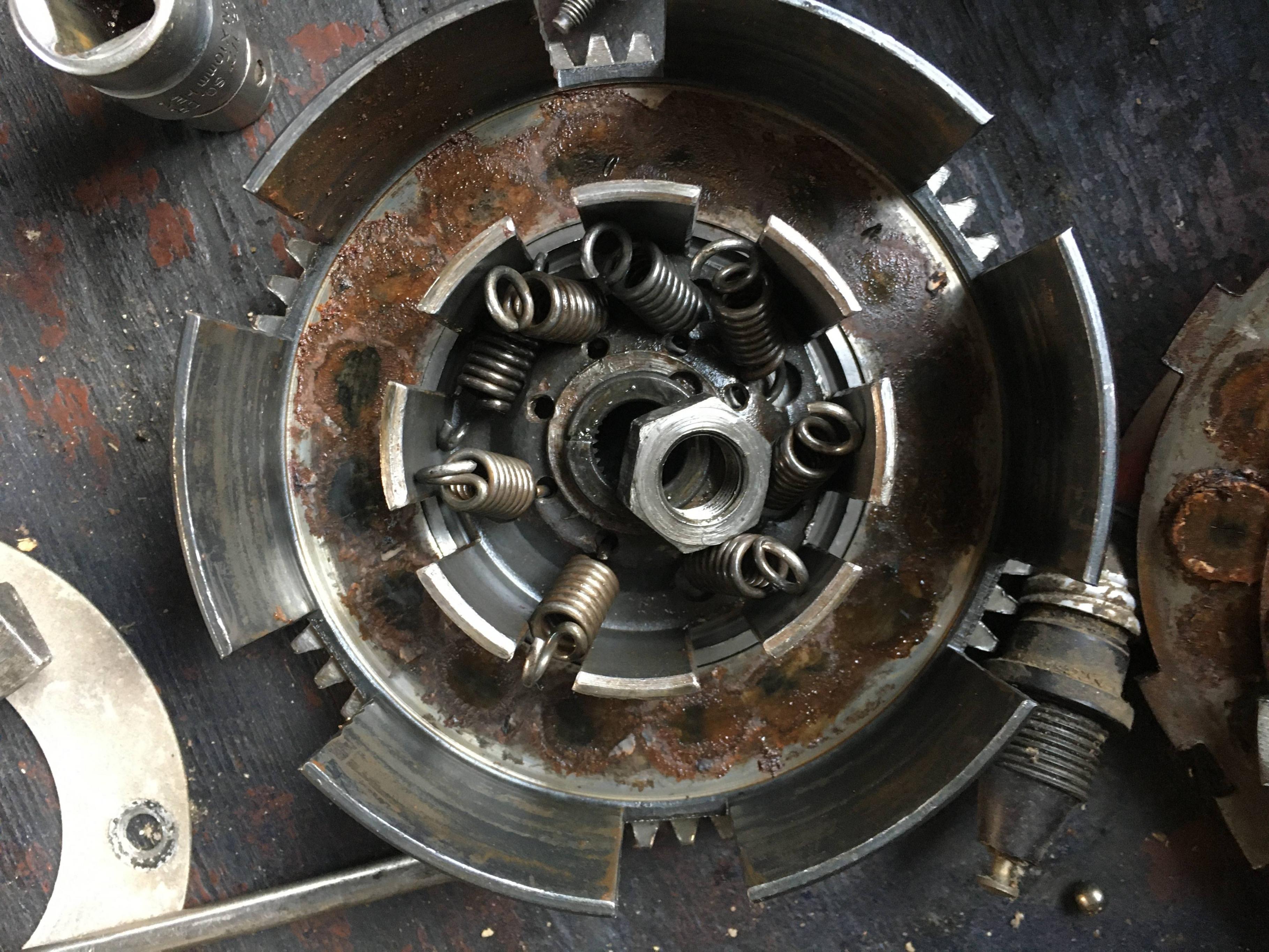

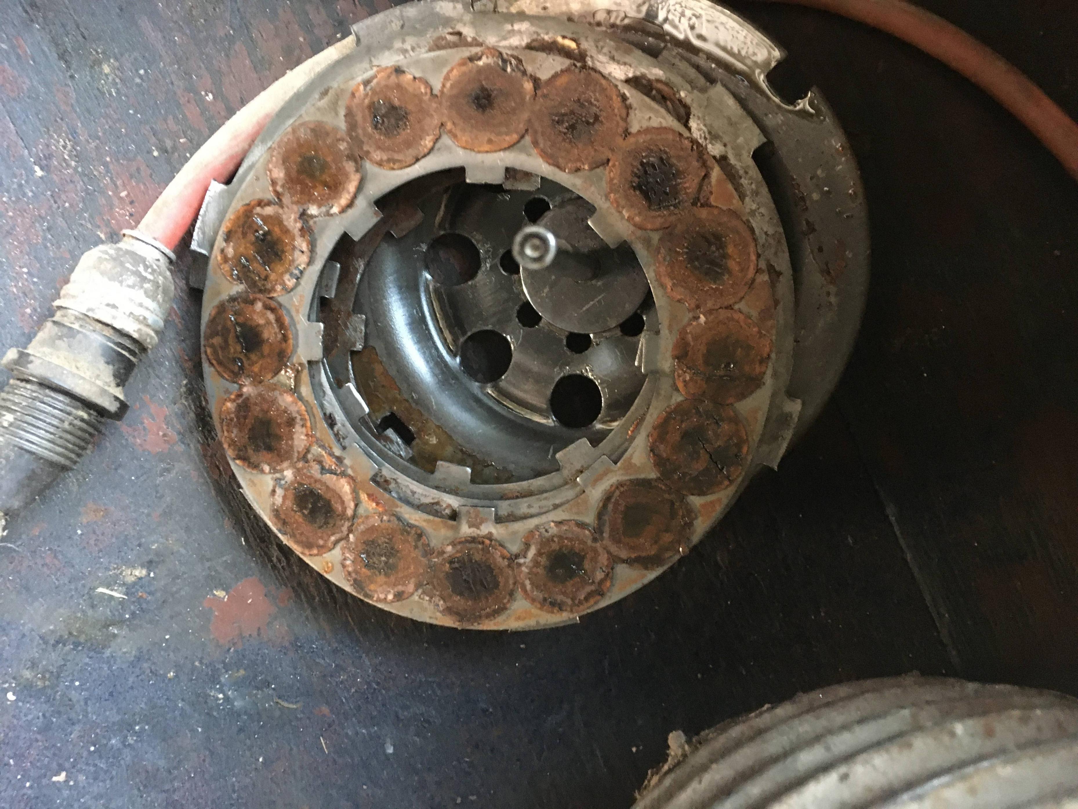

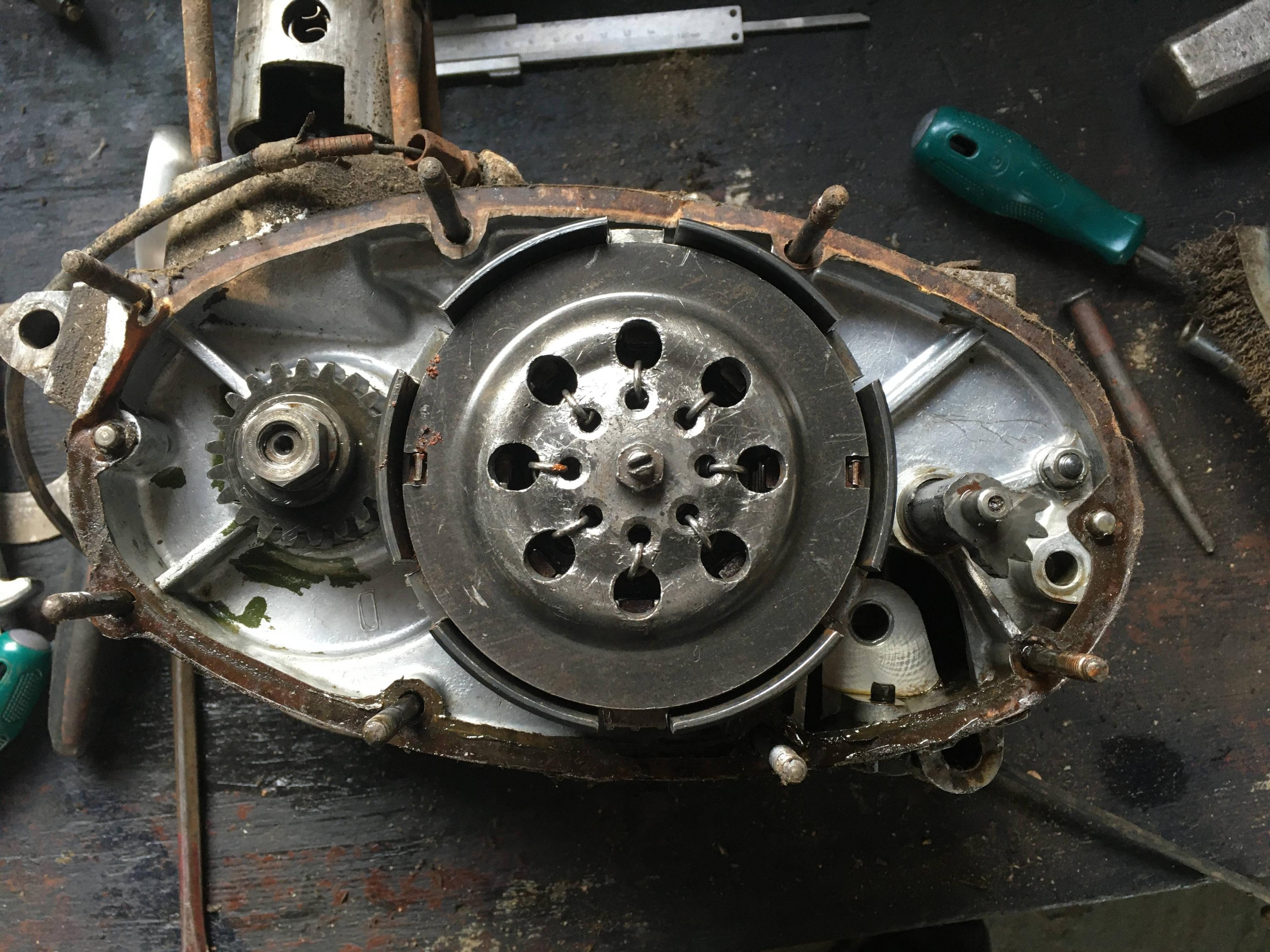

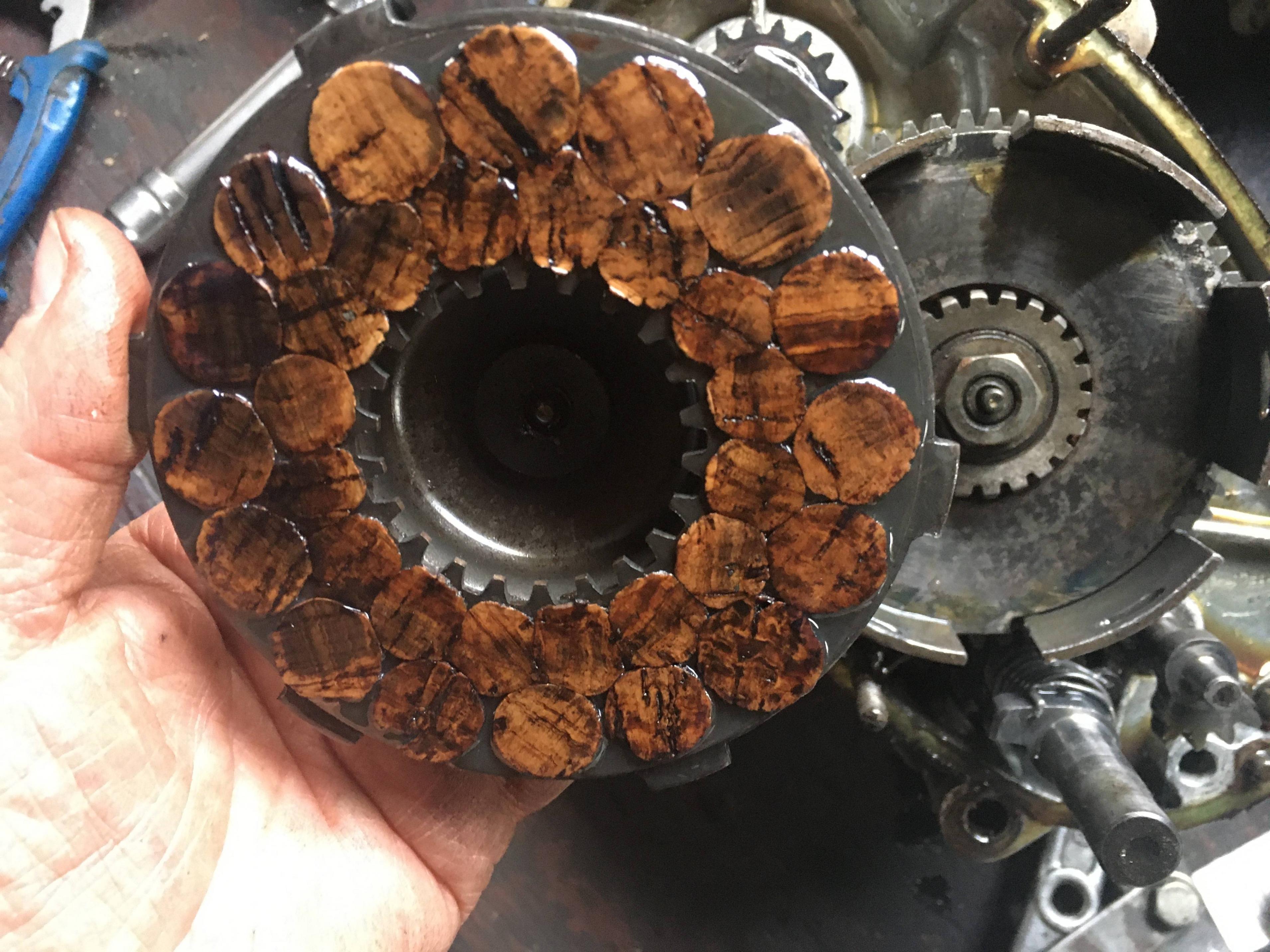

                                Next two photos (fourth and fifth) show clutch discs. I think that this first is from 125/49 but this second? From Pannonia? It has 5 discs, not 2 or 3.
                                On sixth and seventh I show you differences between two clutches. In that first are 2 or 3 discs and on second 5 discs (Pannonia/Danuvia). On eight photo I show all inside this misterious clutch. EDIT: I am 99% sure that it is from Pannonia, but make me sure.
                                On nineth photo I show you some words in Hungarian language.

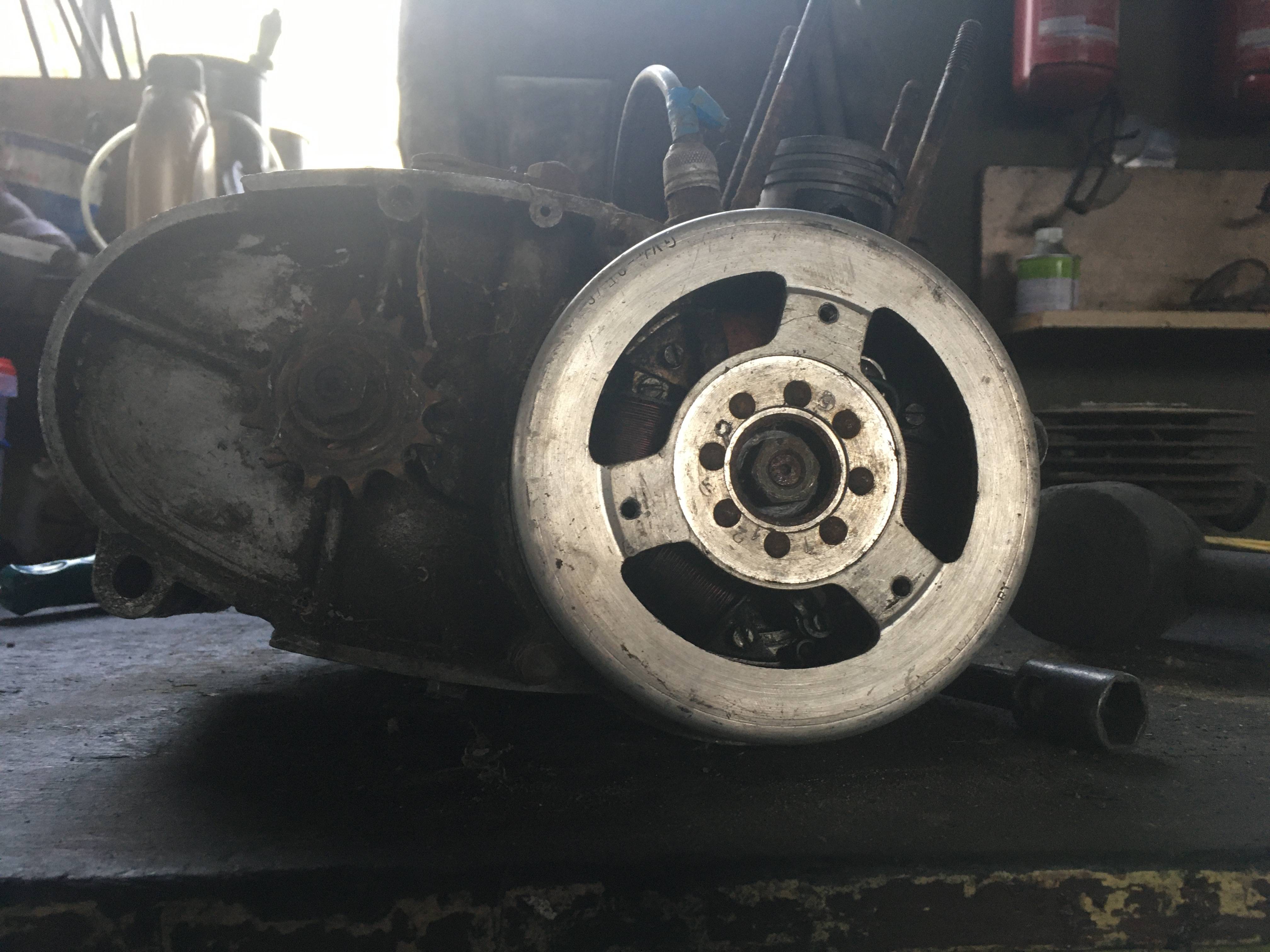

                                On tenth and eleventh photo I show you electromagnet. Is it original from 125/49?
                                Next photo shows gearwheel - this is smaller than on another engine. It should be that bigger or smaller? Maybe I will find it in manual, but I have photo so I am asking.

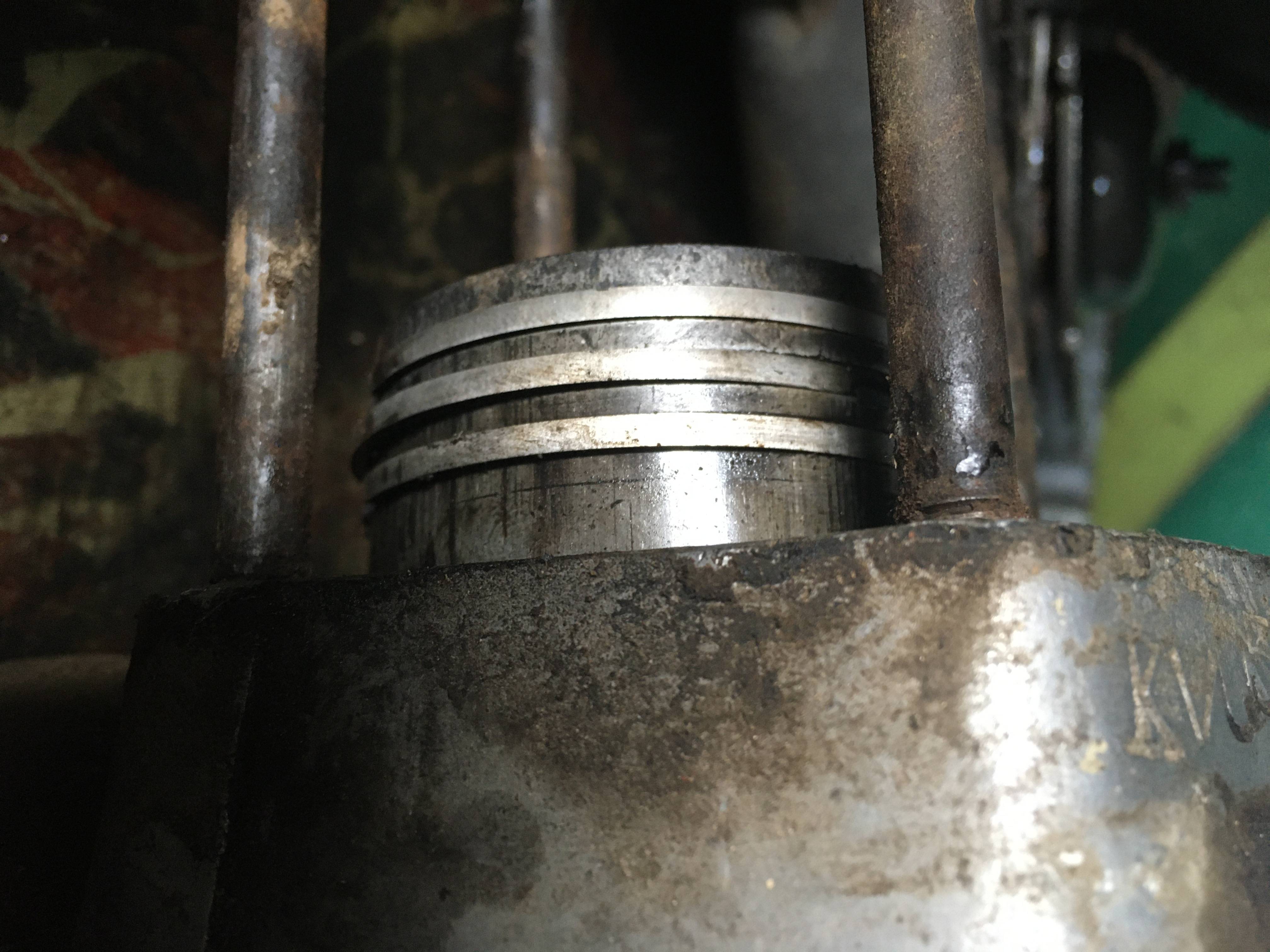

                                On last two photos are pistons. First has two rings and second has 3. Why? I thought that piston from 125/49 has two rings. EDIT: I am 99% sure that piston with 3 rings is from Pannonia
                                Thank you for info. That engines have all history of uniwerse and I have to get parts from all of that 4 engines and make one orignal 125/49 and maybe second to Danuvia, so I must do selection of clutches and others.
                                Regards.
