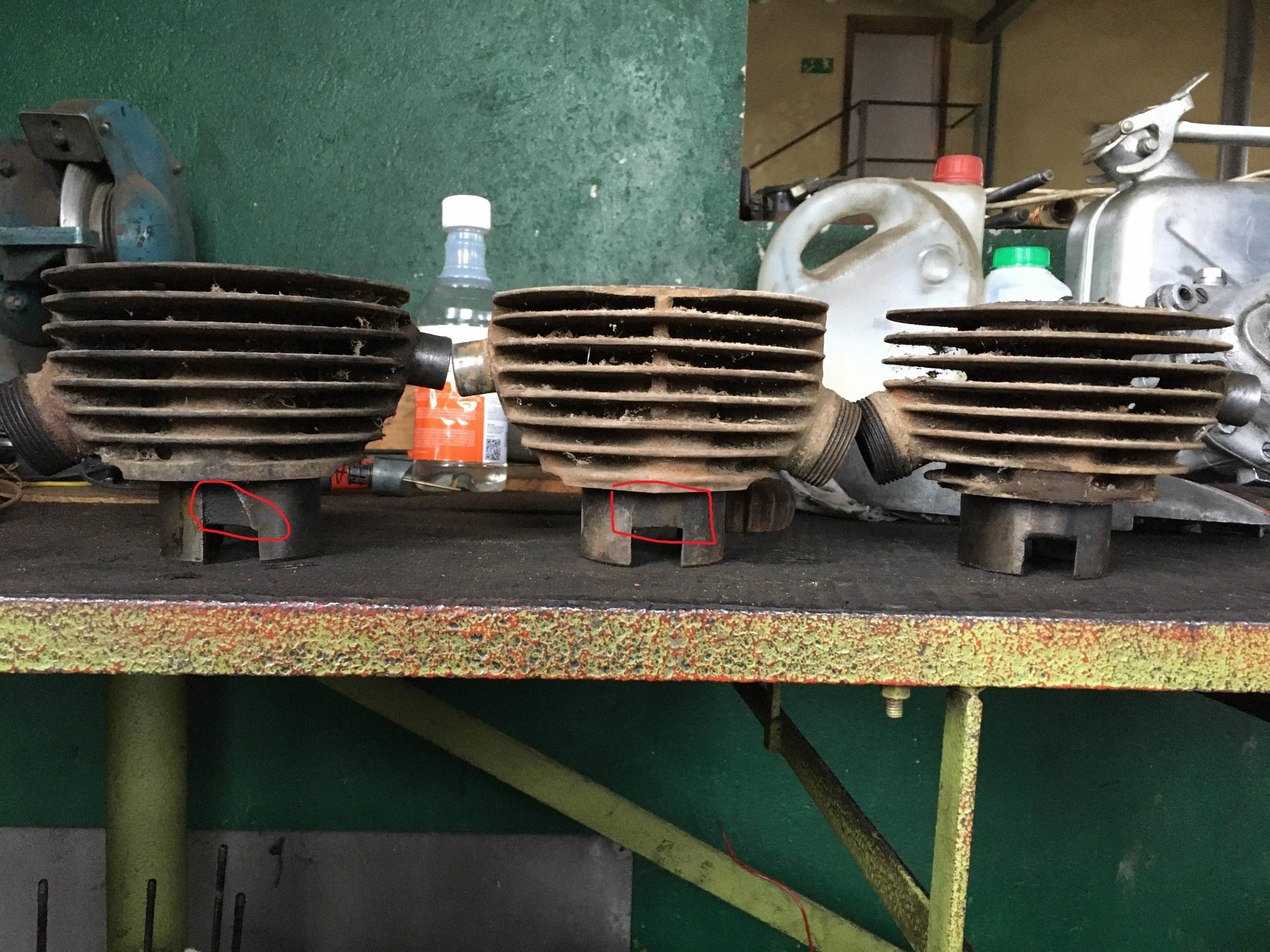

First photo shows differences in cylinders. In the best condition is that on the left (ribs are good) and I want to use it. Second is almost the same, but one detail is strange (red circle). Third cylinder is more empty inside - those on the left are full - I think that it is important.
Second show difference between cylinder on the left from first photo and two on the right. This on the left is more circular and both on the right are more like rectangle.

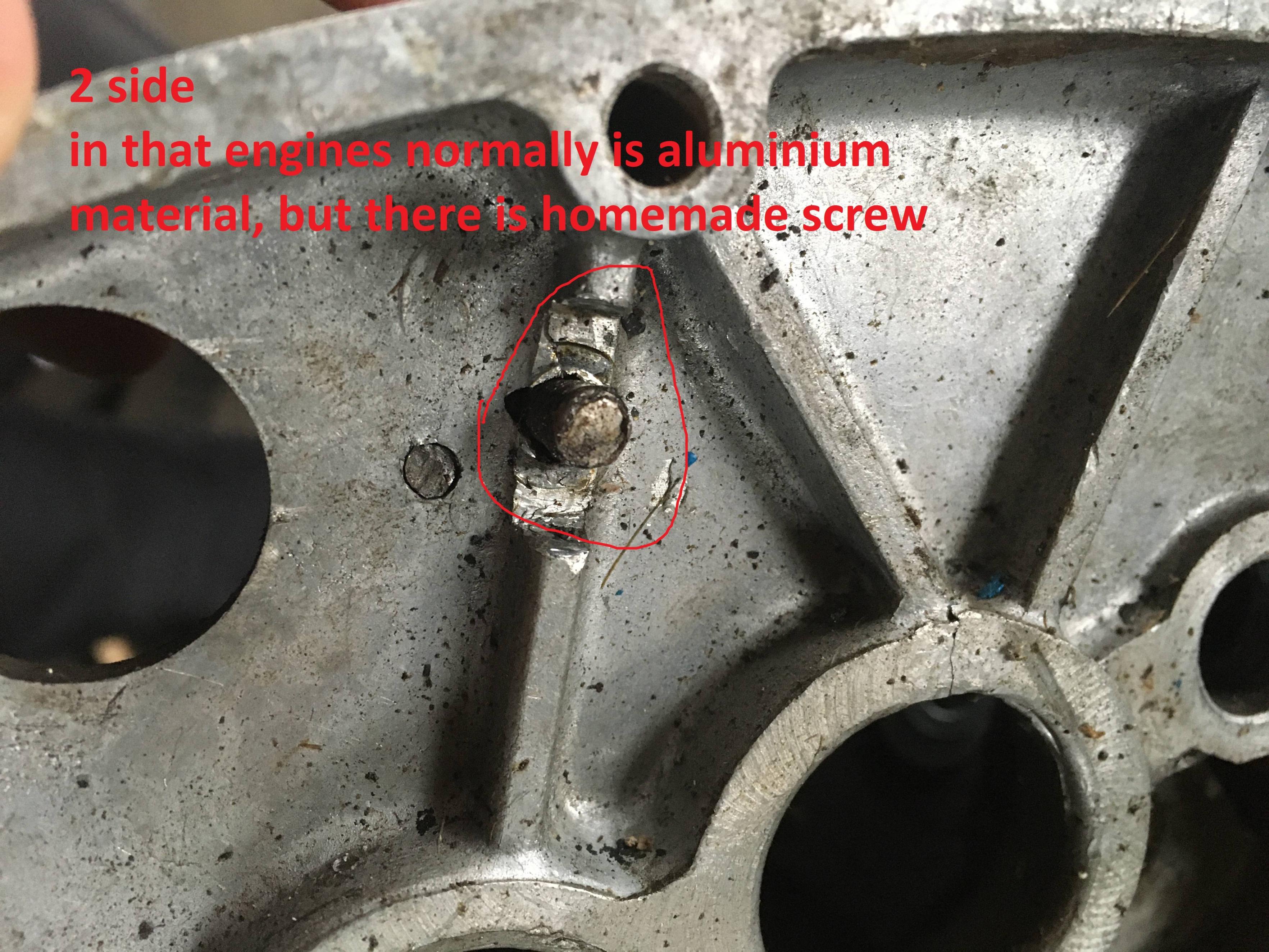

Third photo shows difference between two cores - this with three holes I want to use and this with two holes is from my motorcycle. Question is - is it homemade or important difference between Danuvia/Csepel?

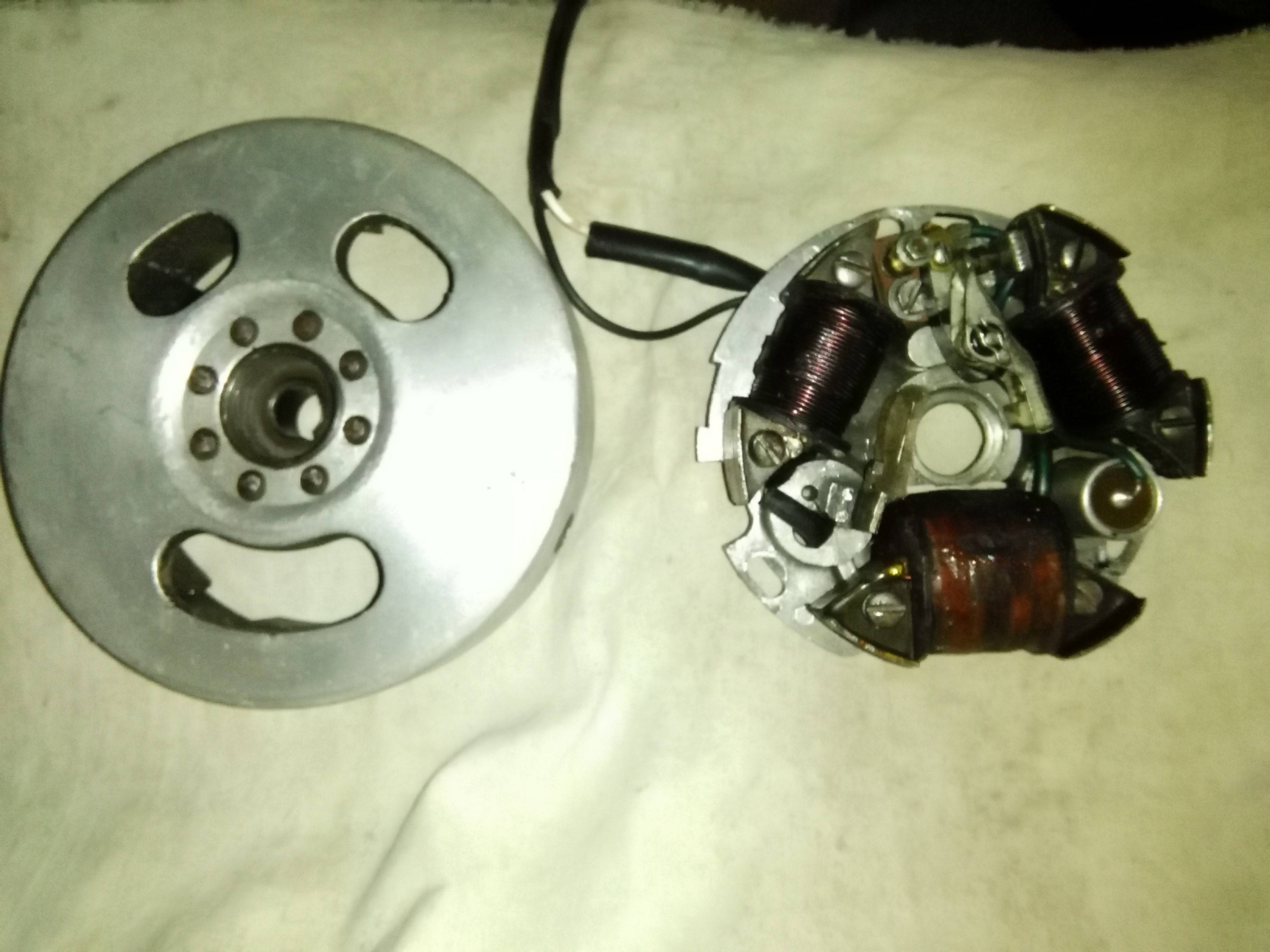

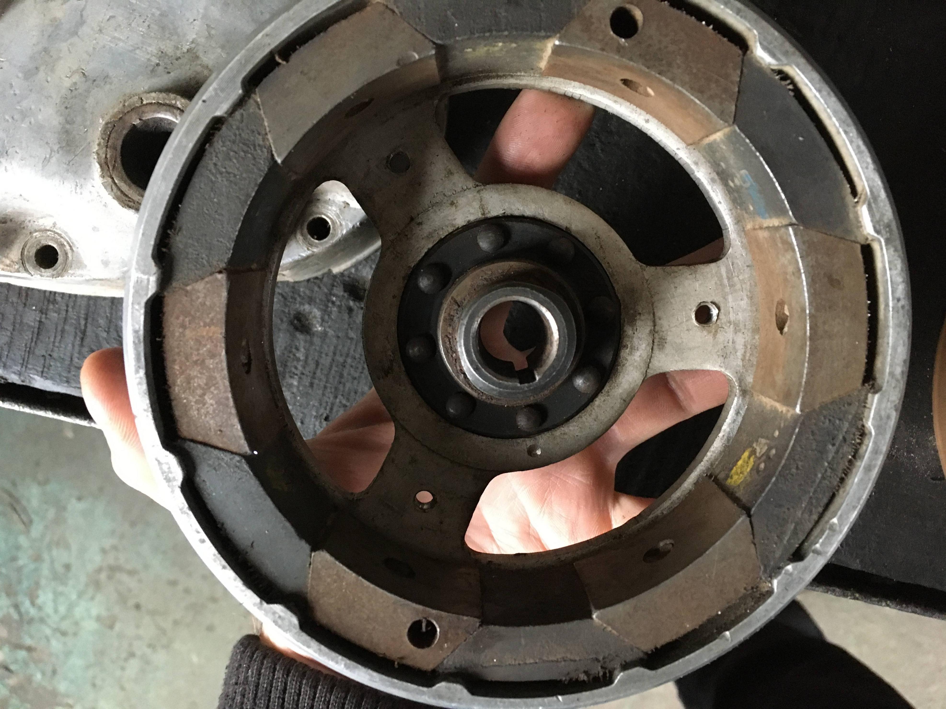

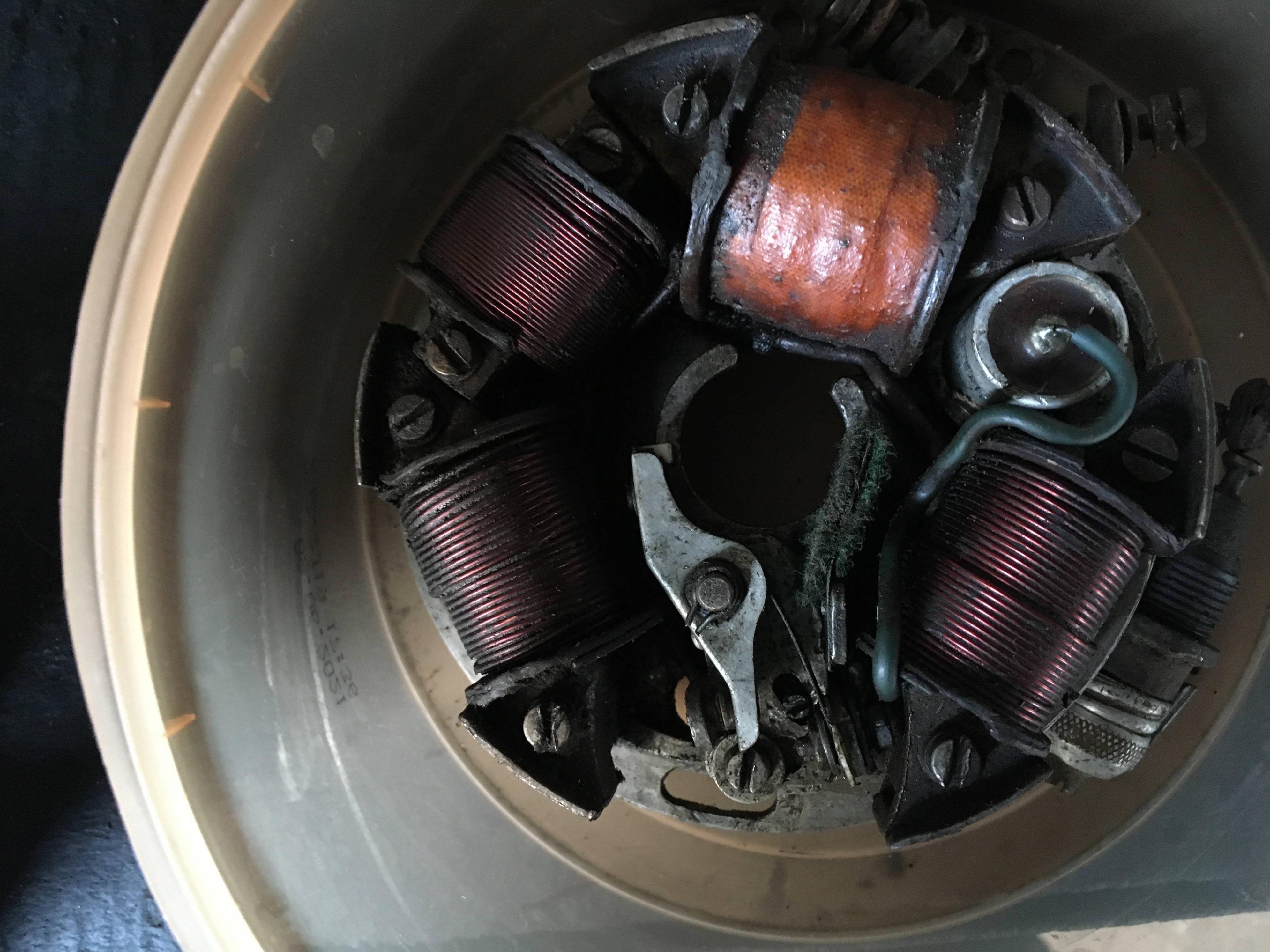

Two photos show magneto - I know that 4 coils mean that it is from Danuvia, but I don't see more differences - I will dismount one coil and should be good.. I think?
The circled detail in my opinion helps the flow. If it is not on the cylinder, the engine is still run.

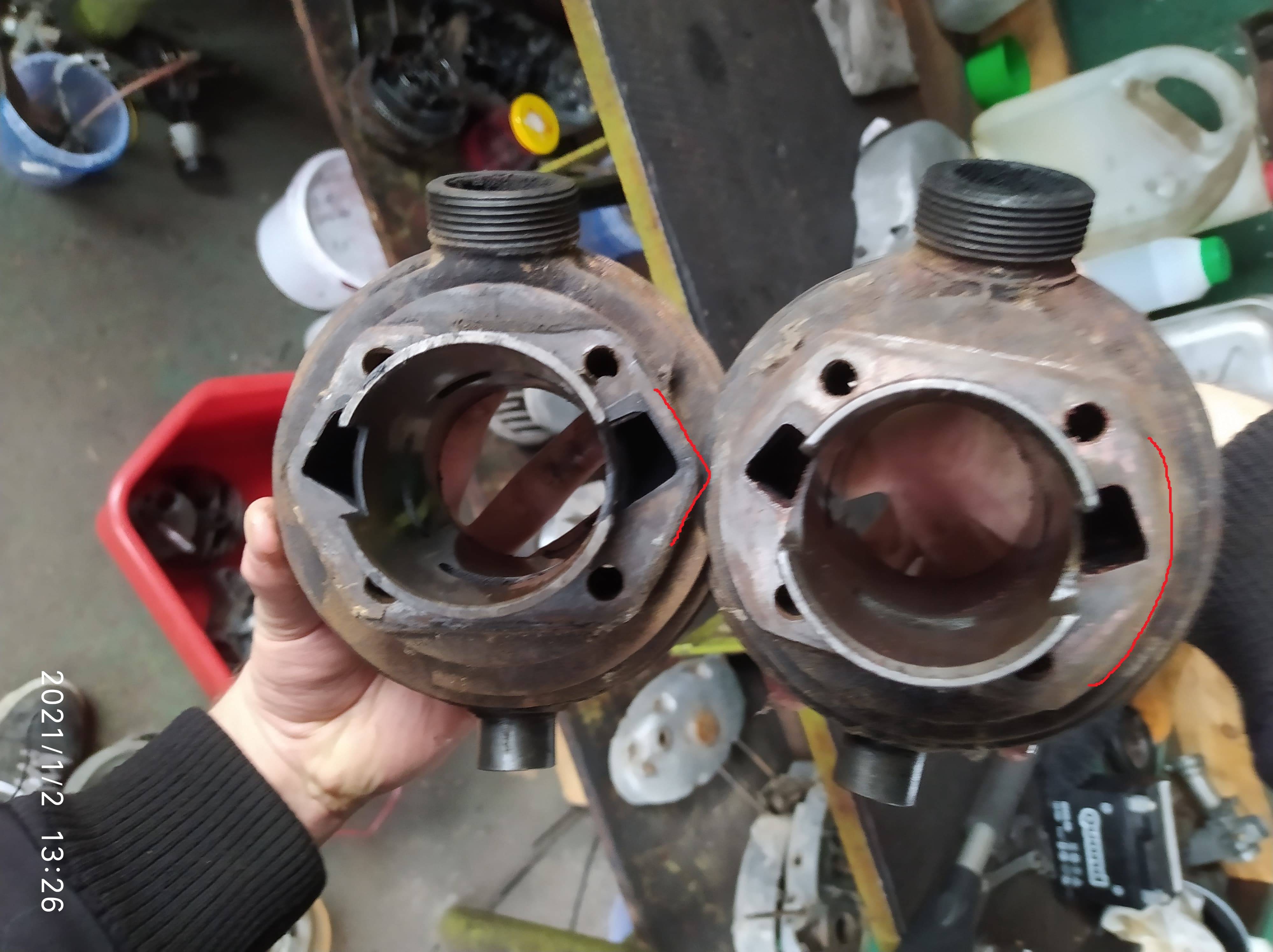

The older cylinders have got angular bottom. After some parts modifying they have got circular.

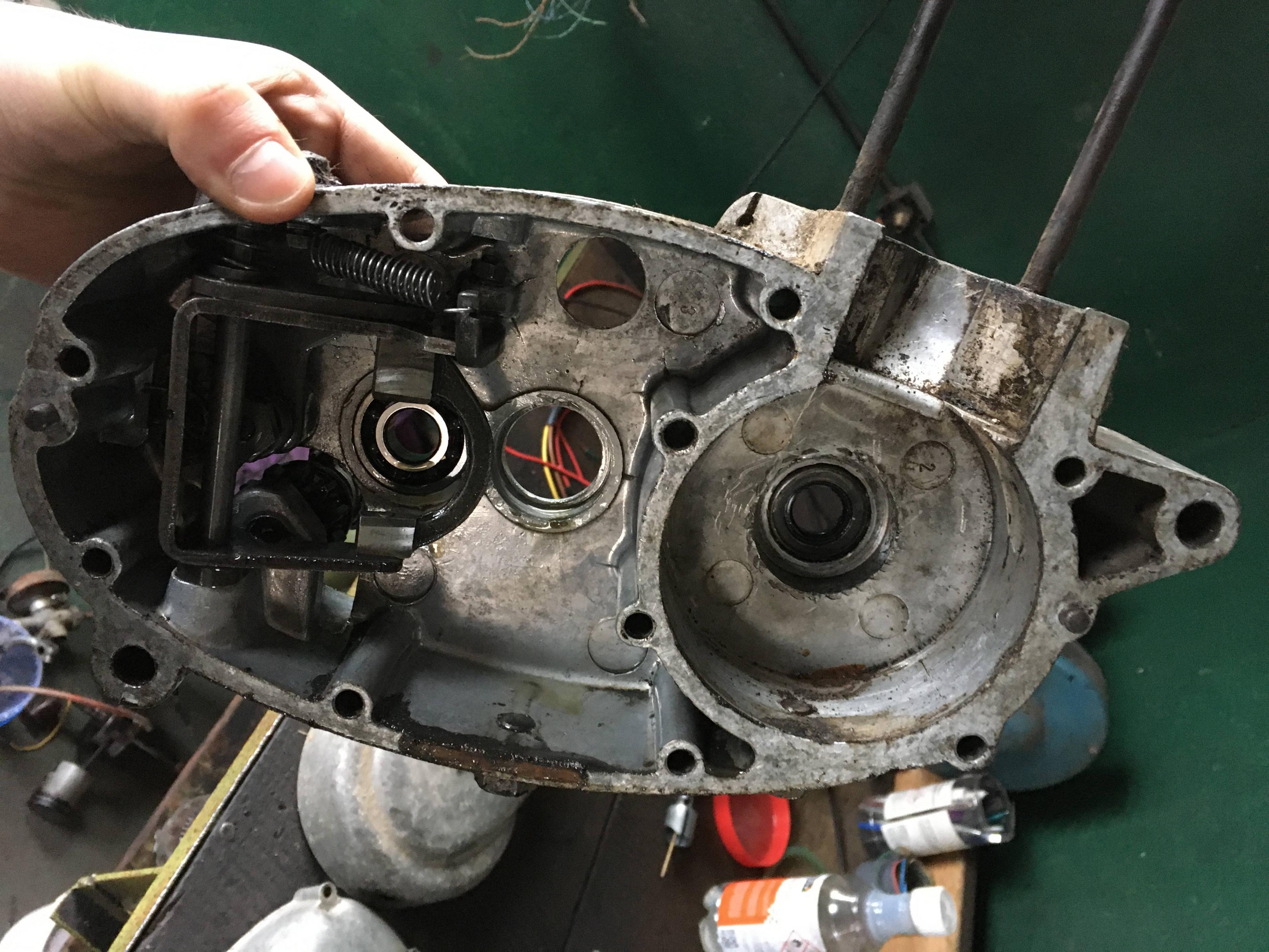

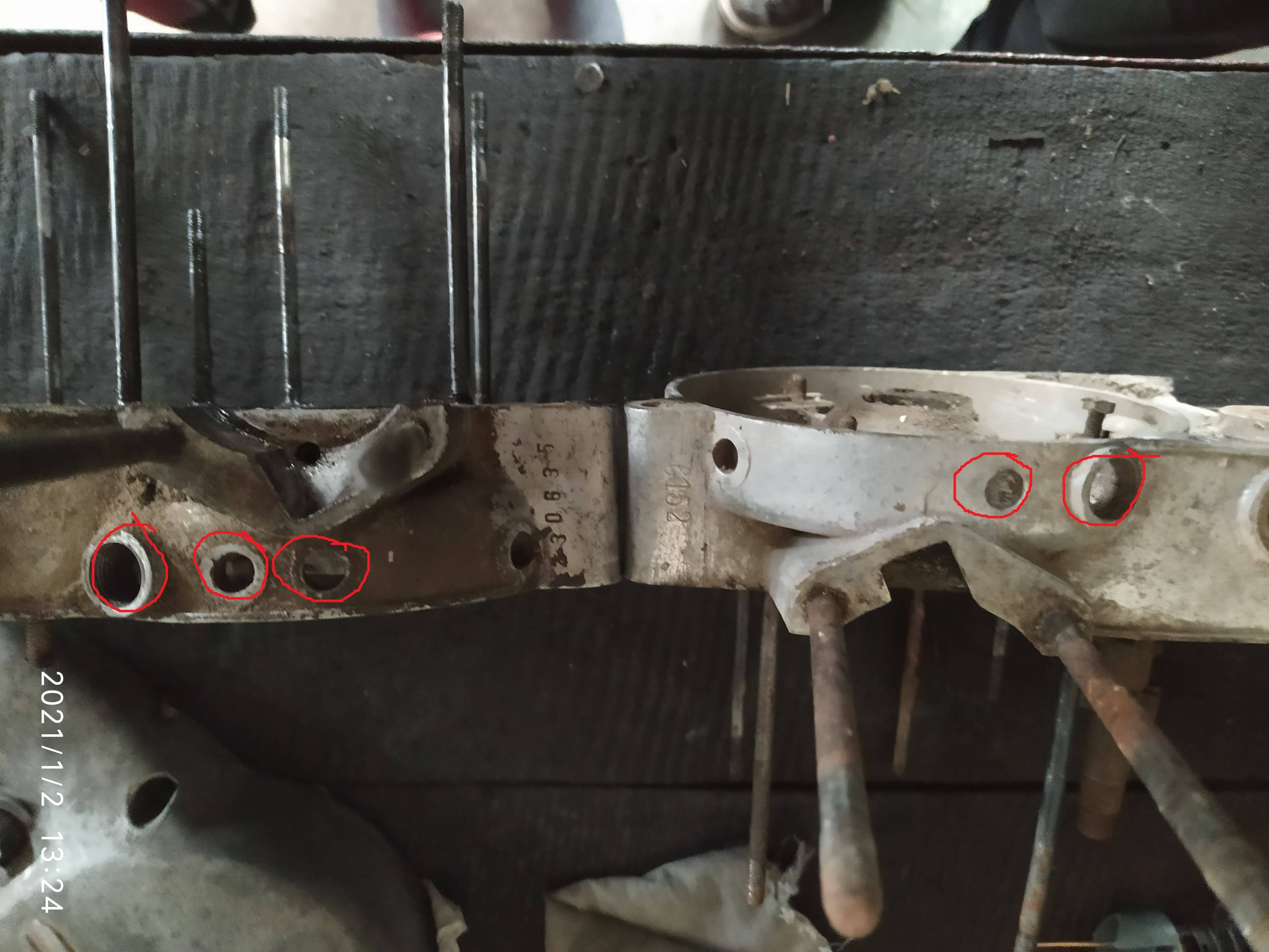

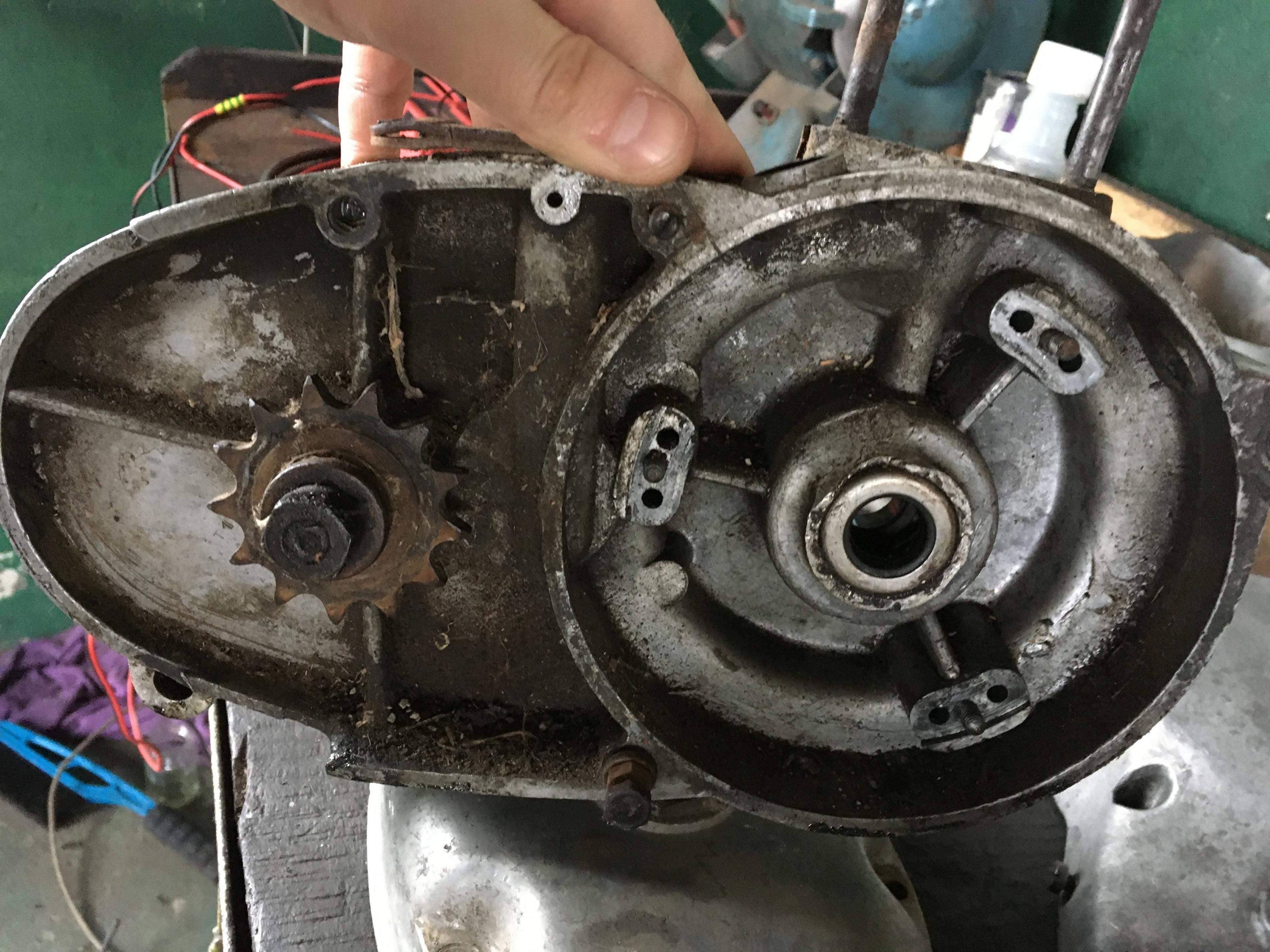

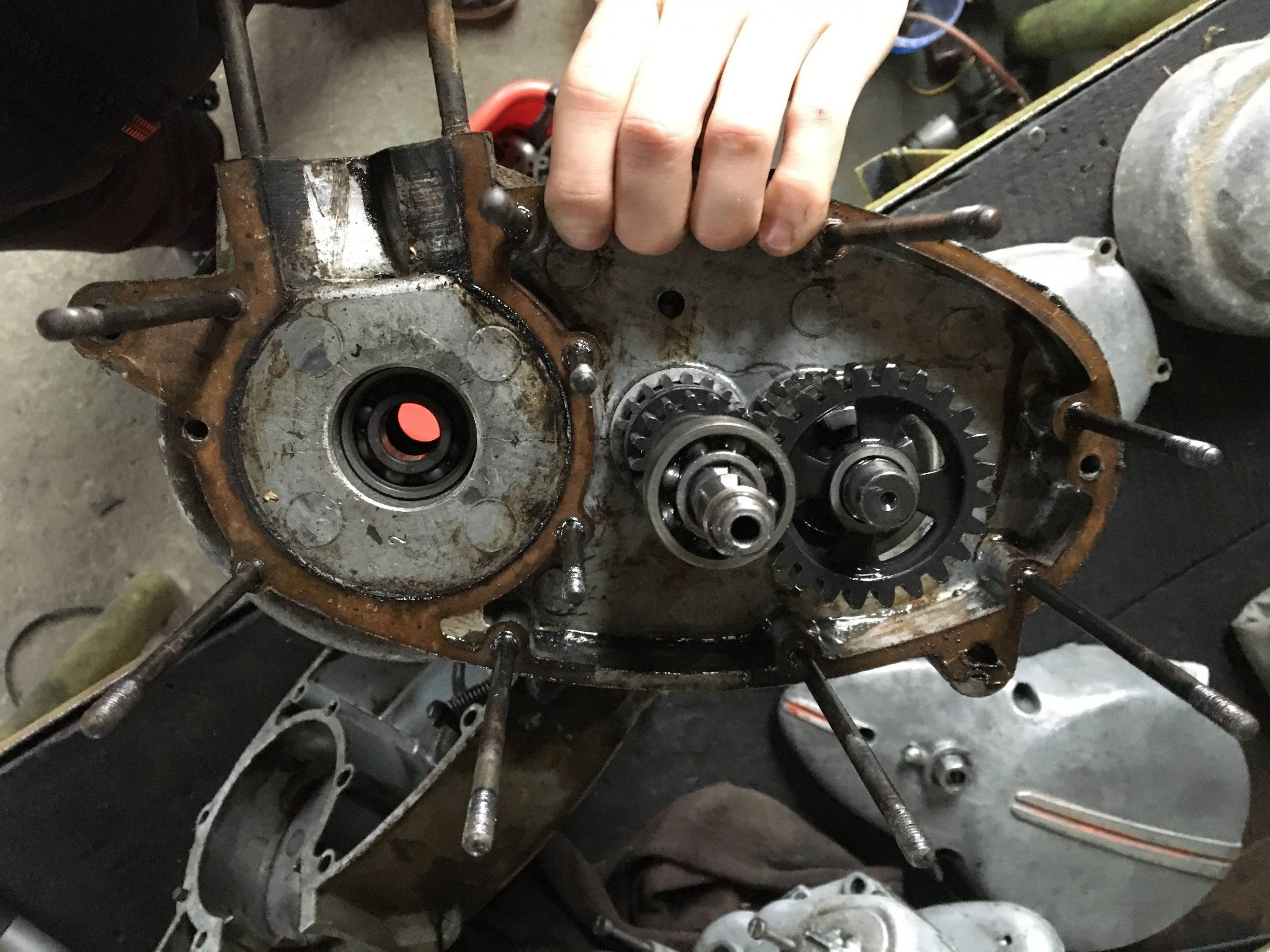

I think, that second hole is homemade. Is hasn't got molding border. Just somebody drill it. Whichever engine you want to use, watch the flowing channel. It must fit to the cylinders channel. Maybe there are a little difference.

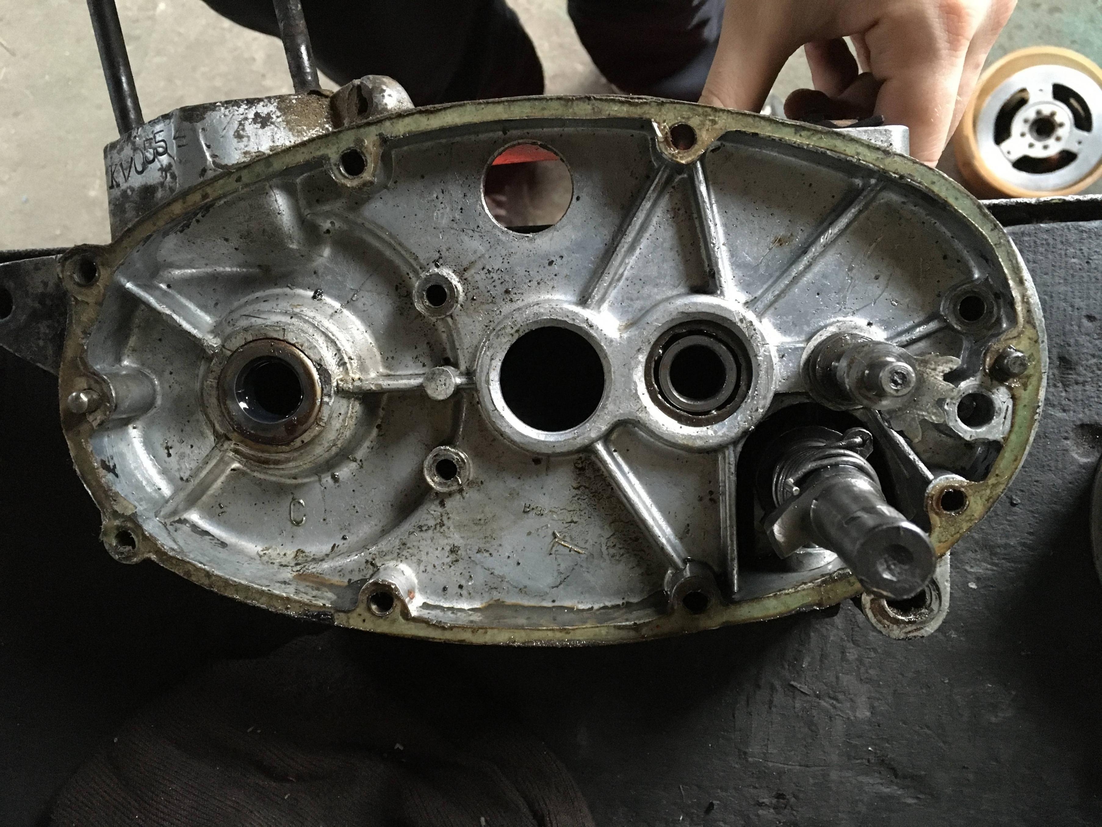

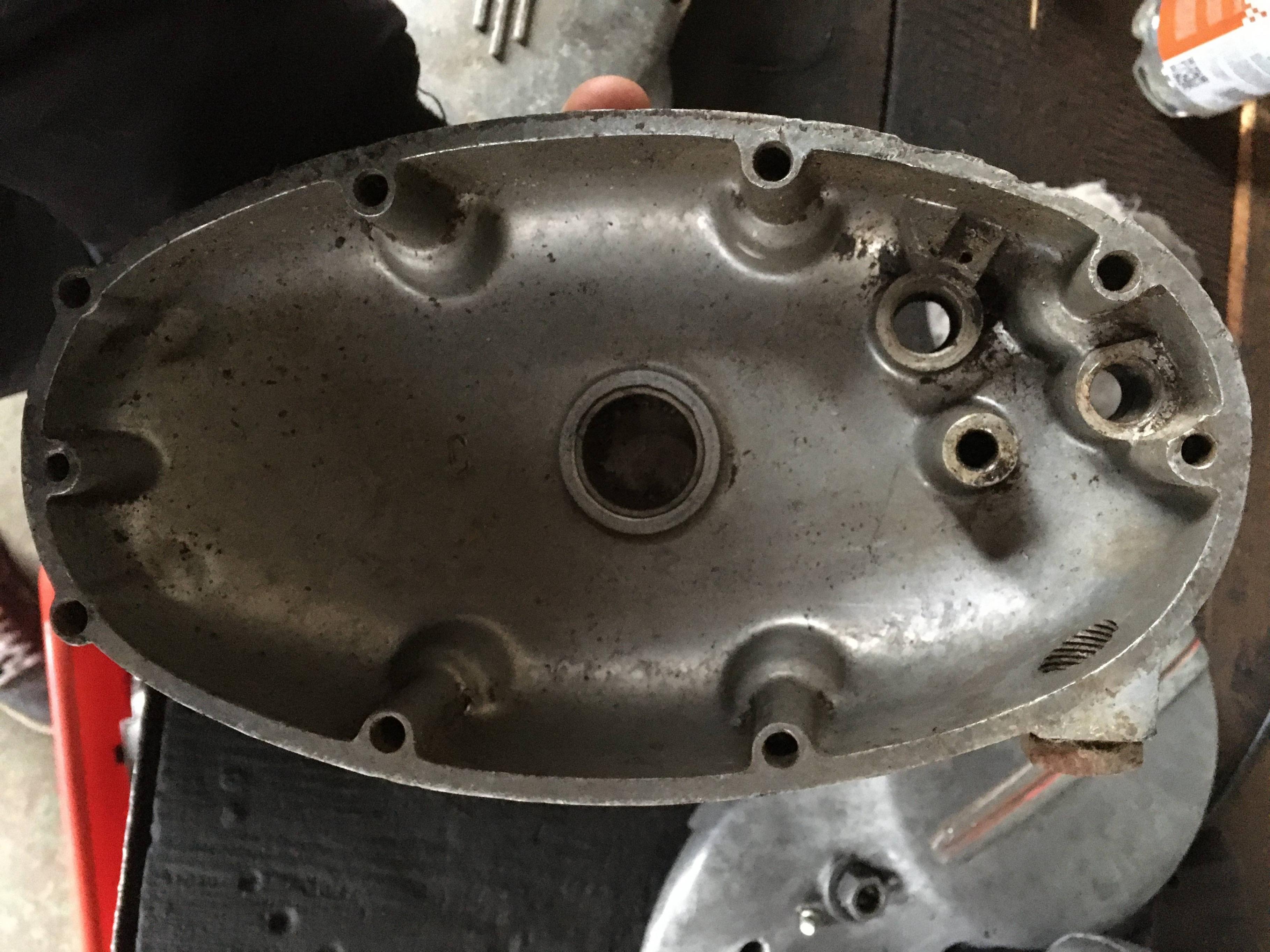

Next photos show covers (I have cover with "CSEPEL" word too - it is obvious) and core of the engine. I use this with different half numbers and engine number KV... I do it because rest are in worse condition. To sum up - maybe i will use this with matching numbers on halfs with frame. This core has no engine numbers - only x2 6152 like on frame and it need to be welded. So maybe if it will get better condition I will use this with matching numbers, but now I prefer to use this from Danuvia maybe.. They are almost indentical - only third photo shows one difference.
As I think, the different block half number don't match. I prefer matching numbers. You haven't got that? Where have to weld the frame pass engine?
The circuit breaker is different from the Danuvia, the others really fit, but I show you one Csepel ignition, just look at what I talking about This one is from one hole engine. The Danuvia ignition also good.

- Az első fotón hengerek közötti eltérések látszanak. A bal oldali van a legjobb formában. A mellette levő szintén hasonló, de amit bekereteztem abban eltérés van. A harmadik még üresebb belül(talán töröttebb?).
- A bekeretezett részek az áramlást segítik, de ha nincs ott semmi a motor úgy is működőképes.
- A második kép a henger talpak közötti eltérést mutatja.
- A gyártás elején szögletes hengertalpak készültek. A másik az újabb változat. Akkor több alkatrész is változott.
- A harmadik kép a blokkfelek közötti eltérést mutatja. Amelyiken 3 furat van azt szeretném felhasználni, és ezt a két furatosat, ami a motorban volt. A kérdésem az, hogy ezek az eltérések házilagos átalakítások, vagy Csepel és Danuvia közötti eltérések?
- Szerintem a második furat házilagos, mivel nem látok ontési keretet mellette, mintha valaki csak kifúrta volna. Akármelyik blokkot is használod fel, figyelj a felömlőkre, hogy passzoljanak a hengerével, ugyanis lehetnek eltérések.
- Akövetkező kép a kuplung fedeleket mutatja. Majd kell egy Csepel feliratos fedél is. A KV... blokkszámút akarom felhasználni, amelyiknek nem egyeznek a párosítószámai, mivel a többi mind rosszabb állapotban van. De talán a saját blokkját is fel tudom használni, csak előbb azt hegeszteni kellene. Ha ez meglenne akkor felhasználnám ezt, de addig is a Danuvia blokkot újítom fel, ha jól látom, csak a kivezetések számában tér el.
- Én úgy gondolom, hogy az eltérő párosítószámú feleket nem érdemes használni. Mindegyik blokkod ennyire rossz lenne? Mit kell hegeszteni a motor saját blokkján?
- Két fénykép mutatja a gyújtást. Már tudom, hogy a négy tekercs azt mutatja, hogy Danuva gyújtás, de ha kiveszem a töltőtekercset az úgy már jó lenne igaz?
- Még a megszakító is eltér a Danuviáétól, de a többi az teljesen passzol. Mutatok egy képet Csepel gyújtásról, hogy lásd miről is beszélünk. Ez egy kivezetéses blokkból származik. A Danuvia gyújtás ugyanilyen jó.

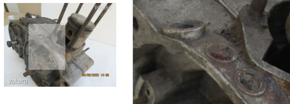

I did research and Danuvia engines have 3 holes. You can see it on first photo from Vatera offer. In addition to that, my 3 of 4 engines has 3 holes and only from my motorbike has 2, so it is not an accident. Next thing is that Danuvia has 4 coils not 3 and that's why there is additional hole to let next cable/pin out. Now we know more
It is on next three photos and I highlighted it with red color. Fourth photo shows opposite side of photo number 3. I think that it is hard to repair.. So I will use core from Danuvia - only difference is additional hole which I can fill.
Yes, I found out it! Difference is small, but I see difference in the magneto - smaller holes I think. You can see it on post #45 fifth photo. It is not important, but it is my observation. Thanks for photo
Yes, Danuvia engines have got 3 holes to the wires, but I'm still suspicious to your 2 holes engine. Can you take a close up photography of the second hole?

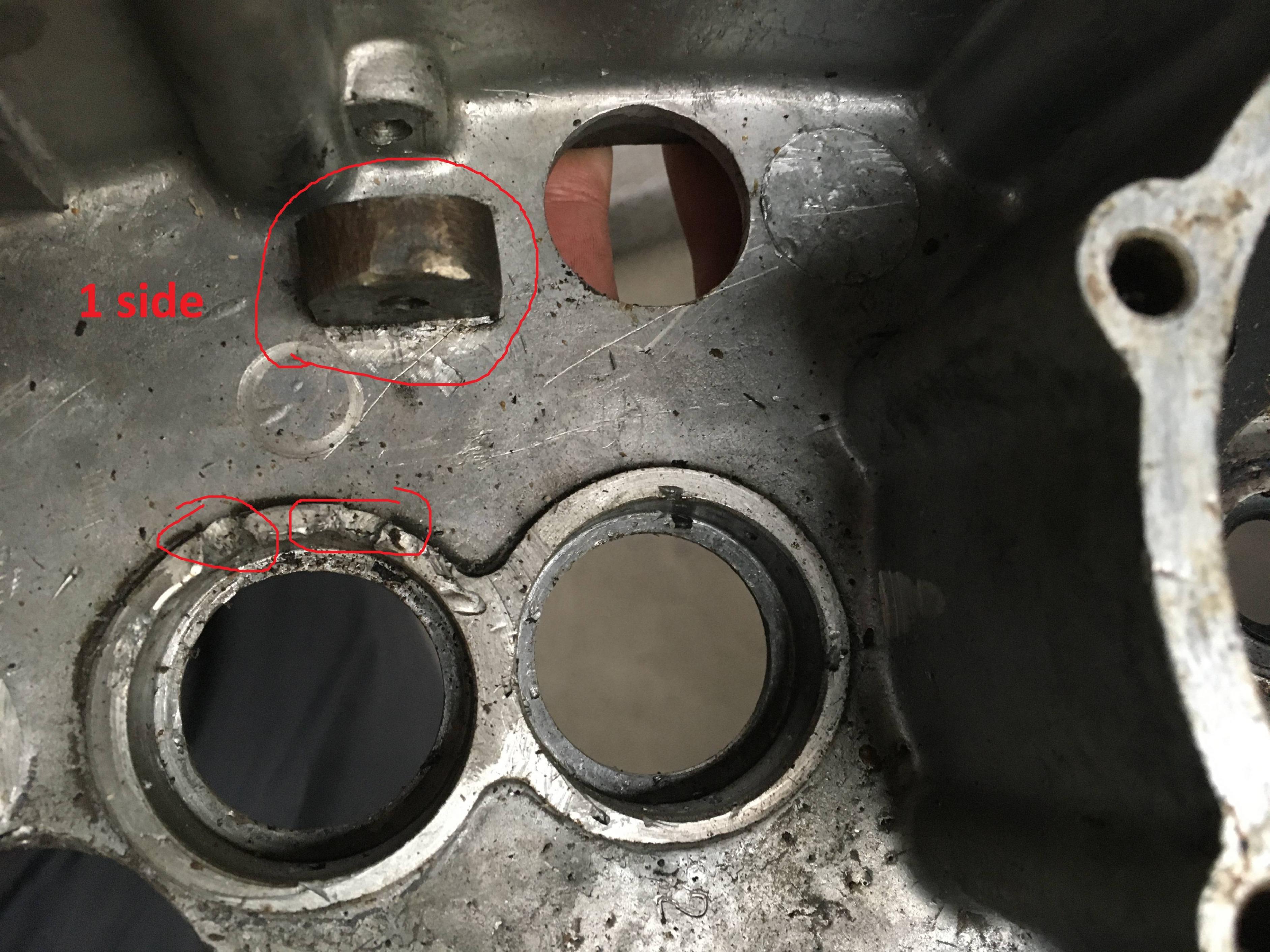

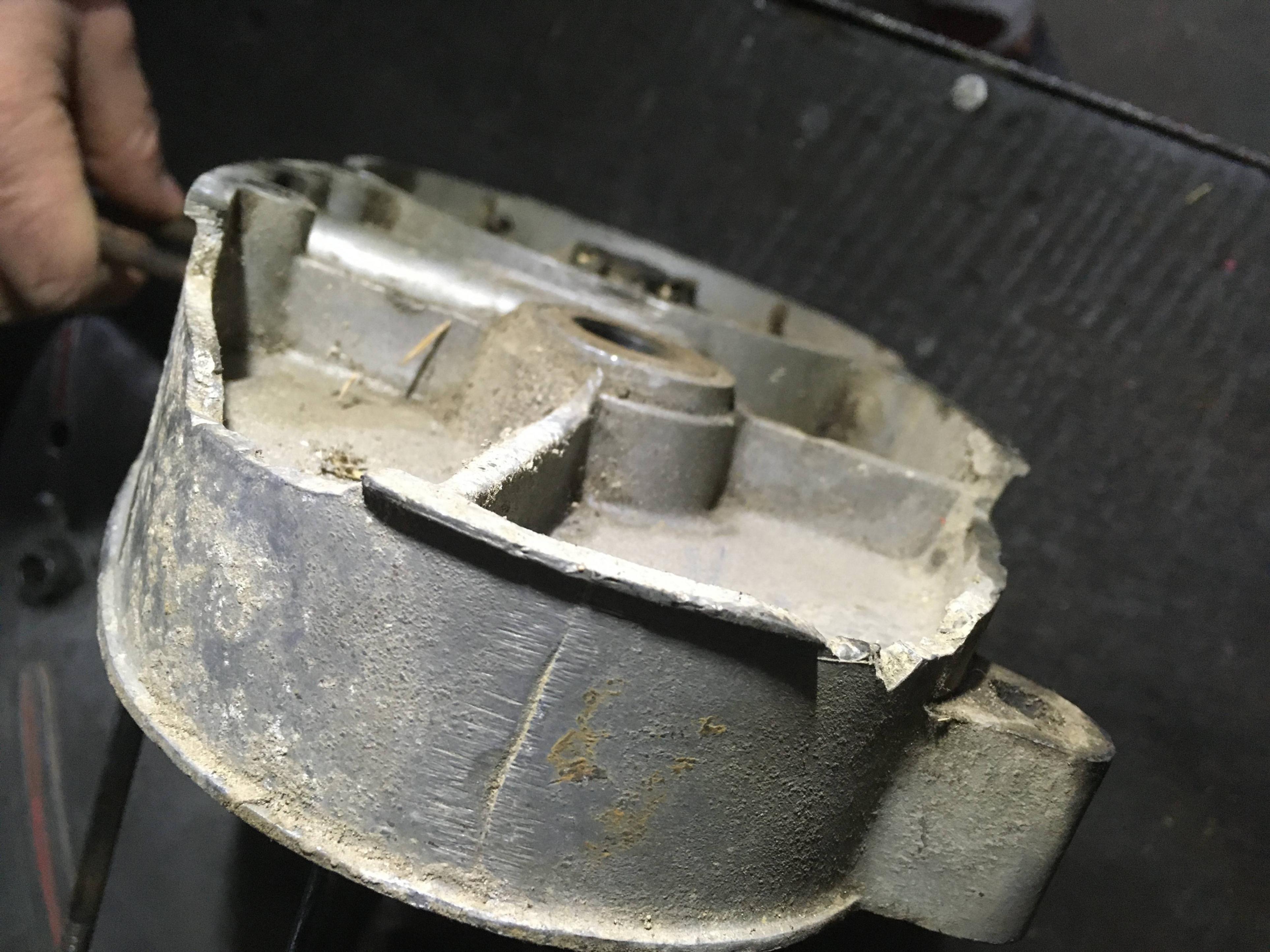

It looks like the engine fell on the concrete. Not lucky. What we can see on third and fourth photo, it can still work, but the intact is the best. I don't know the quality of the repair. Permanently mount the older clutch to a good condition Danuvia engine.
Mainly the setting is different between the two breaker. In appearance they are similar. And I see now in the 45. post on photo 5, 9 and 12 the original piston

- Ahogy eddig megfigyeltem a Danuvia blokkokon mindig 3 kivezetés van, ahogy ezen a Vaterás képen is látszik. Ezek szerint a 4 blokkomból 3 Danuvia, csak a motorom saját blokkja két kivezetéses ami nem véletlen. A Danuvia gyújtása 4 tekercses, ahhoz való a 3 kivezetés. Ennyivel okosabbak vagyunk.
- Igen a Danuviáknál mindig ennyi van, de énnekem még mindig gyanús az a második kivezetés. Tudnál róla készíteni egy közelebbi képet?
- A következő három képen bejelöltem, hogy mik a blokk hibái. Ezeket a hibákat nem könnyű megjavítani. Inkább a Danuvia blokkot fogom felhasználni.
- Ez olyan, mintha a blokk betonra esett volna le. Nem valami szerencsés. Amit a 3. és 4. képen látunk attól még működhet is a blokk, de egy sértetlen blokknál nincs jobb. A régi kuplungot véglegesen beszerelheted egy Danuvia blokkba.
- Igen, látom én is a megszakítók és a mágnes eltérését. Ez szerintem nem annyira jelentős. A 45. hozzászólás 5. fényképén jól látszik.
- Főként a beállításban tér el a kettő magszakító egymástól, külsőre azonban hasonlók. Most újra megnézve azokat a fényképeket az 5,9. és 12. fényképen eredeti dugattyút látok.
This with 3 holes are engines from Danuvia - this with two holes is from my motorcycle - I will do photo tomorrow with bigger zoom. Now you can only look at post #52 third photo. What about being suspicious... I am 90% sure that this halfs numbers were grinded and numbers were made again.. but it looks like only one which is from 125/49 - not from Danuvia.
Yes the third photo. I made a little edit on it. The second hole is suspicious, where is the hole border? I don't see it. Maybe it is home made hole, like the numbers.

- Ez a három kivezetéses Danuvia a kettő pedig a motor blokkja. Holnap készítek nagyobb felbontású képeket róla. Az 52 hozzászólás 3. képén láthatod a blokkot. Nem értem, hogy mi a rejtélyes benne, 90 százalék, hogy a számait kicsiszolták, és a motor vázszámát ütötték bele. De mind közül ez az egyetlen az, ami nem Danuvia blokk.
- Igen a harmadik kép. Egy kicsit átszerkesztettem. A második furat a rejtélyes, mert hiányzik a szegélye. Én legalábbis nem látom. Talán ez is egy házi alakítás, mint a számok.

- Az eredeti blokk rosszul fest a képek alapján, de ha jól sikerül a javítás akkor mindenképpen az illik a vázba, bár a Danuuvia felújítása gyorsabban megy, így előbb sort keríthetsz egy tesz körre.
- A hengereim közül egyik alapméretes, de fel kell fúrni, a másik bordái töröttek a harmadiknak pedig 55 mm az átmérője, ennél már 55,5 mm lenne a következő méret.
- Akkor nem úszod meg az új dugattyú vásárlást.

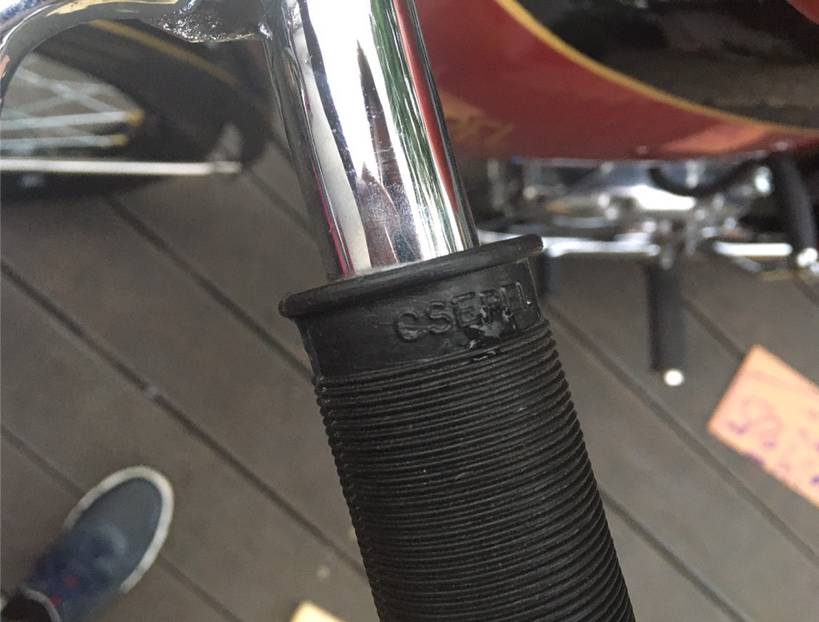

- Egy ilyen gázkart keresek. Ha tudsz eladót írd meg és megvenném. Szerinted világos vagy fekete markolatgumi illik a piros-fekete fényezéshez?
- Utánanézek a gázkarnak. Egy piacon láttam olyannál, aki több utángyártott alkatrészt is árult. A markolatok gyárilag világosak voltak, de manapság csak feketét árulnak. A Danuviának létezik világos markolata, de annak a mintázata eltér a Csepelétől.
